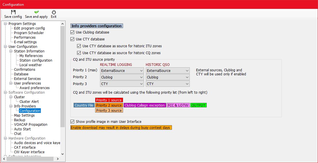

Have you changed (or has Murphy's Law crept in and changed) your Info Providers priority order? Clip below show recommended order.
On the Configuration / Info Providers page double-check your QRZ connection with the Test Connection button as well.

- infoprovidersconfig.JPG (96.36 KiB) Viewed 1157 times

Thank you so much! Murphy had got in and messed with that order - no idea how!
Problem solved for me.
