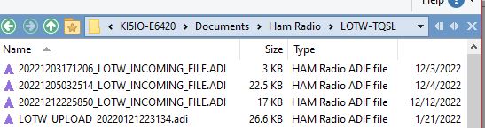

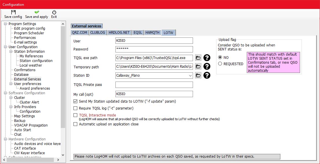

Did you set up the Temporary Path at: Configuration / External Services / LOTW ??
Screen clips below is for my setup for LOTW as well as my temporary path. I created a folder called "LOTW-TWSL" and located it under a Ham Radio Folder that is under my Documents folder.
You can put that temporary folder wherever you want and where it can be written to without blocking by the Windows O/S security.
You warning flag indicates that you have not yet set up that temporary folder.
I would locate it in a folder in the "Document" folder on your installation. That way you are sure Log4OM will actually write/save the file being created.
- LOTW-folder-config.JPG (33.36 KiB) Viewed 819 times
- LOTW-config.JPG (106.49 KiB) Viewed 819 times
Re: Error Uploading to LotW
Nolan, thank you very much. That was the problem. I had set up a temporary folder but it was located inside C:\Program Files (X86)\TrustedQSL like it is on my other station/computer. I guess WIndows or LotW doesn't like it being in the program files directory. I made the change and I was able to upload it successfully.
