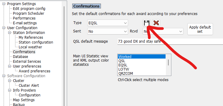

Did you save using this save icon before save and apply? if not thats your issue
Screenshot 2023-02-10 232534.png (38.14 KiB) Viewed 698 times
