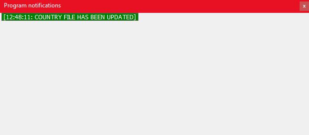

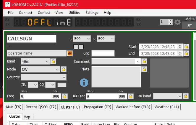

Re: HRD Log realtime upload not working since 2.27
Bhanu,
The update works in the background. Once completed you get an Information Icon alert and if you left click on that icon you will note that the specific update you have requested has been completed.
I just did the same Country update, as you noted, and it took over a minute or more.
Images below are what appeared on my Main UI once the routine was completed.
Dear Nolan KI5IO,
Thank you for your support.
I will look for it. We have an old habit to see a popup confirmation.
Bhanu
VU2MB
