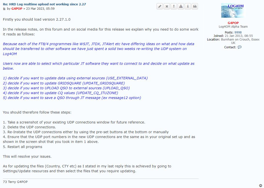

Going over the Release Notes has all the basic information you need that we've all been trying to get you to follow.
Here is a link with some of that same information repeated:
https://forum.log4om.com/viewtopic.php?p=43147#p43147
I've also added a screen clip from Terry - G4POP with the same information plus a couple more basic "how to" steps that he share in another thread on this Forum.
I'm certain if you follow those steps you will resolve your issues.

But this applies to FT8 in the last version, and it does not log SSB for me and neither in 2.24 nor 2.25 was not logged :-(
Re: Problem with upload to HRDLOG service
sp5ah wrote: 26 Mar 2023, 19:39 But this applies to FT8 in the last version, and it does not log SSB for me and neither in 2.24 nor 2.25 was not logged :-(
Piotr,
Did you see Rich's KD0ZV reply above? He did a test with that upload and it worked FB. Terry has also tested same and it worked FB.
We (so far) do not have any other reports from other OMs experiencing your situation. In fact I've had a couple direct e-mails from OMs advising me that their uploads to HRDLog are also working FB.
So ... something (not sure what) is amiss at your installation as best we can determine so far.
Now ... did you enable the Debug logging mode, make some upload attempts to HRDLog, save that log and then create a Support Request and send to Terry - G4POP?.
And you have noted that you have not been able to upload to HRDLog in prior versions 2.24 and 2.25 ... So ... again something is amiss with your setup. Make sure your code is properly entered with uppercase, lowercase, etc., etc..
