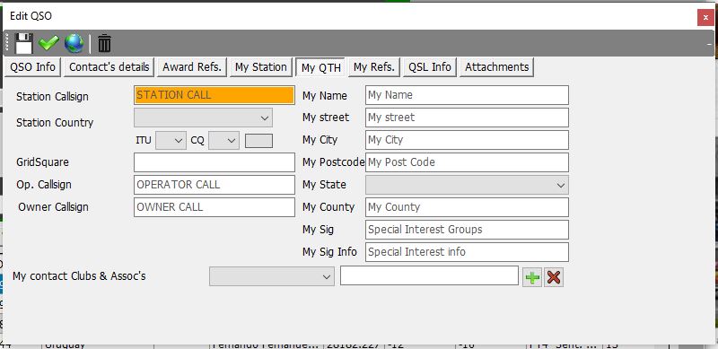

This is resulting in both the "my QTH" and "QSL Info" windows under the Edit QSO option not being filled in as below, Images attached.

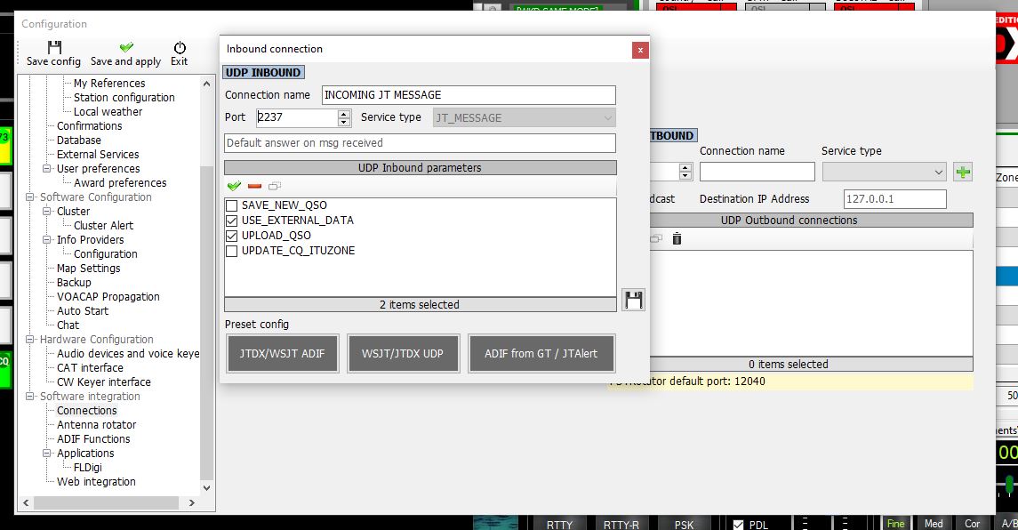

I have my connections like so:
Not sure if I need all 3 set the same, but it was the only way I could get it to work for me. and nope.. I turned the ADIF_monitor off as you said in my last post.
I must say that I am totally lost within this new version and the UDP connections required.
thanks
Re: DBSQLITE error
1. Please read this https://forum.log4om.com/viewtopic.php?t=8260 then read it again
2. Use preset buttons at bottom
3. User guide
4. Are you also using adif monitor???
