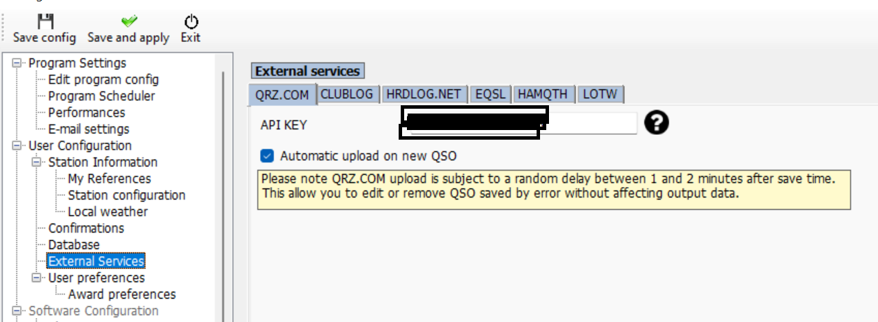

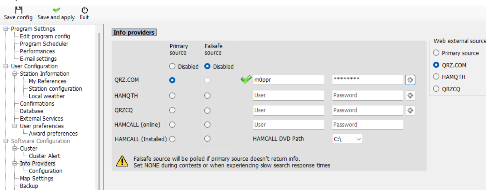

Please see all 3 attached pictures. Last Sunday (26.03.2023) my LOG4OM 2.27.1.0 stopped uploading QSOs to QRZ on the go - I have XML subscription from them. Before that day everything was ok. I spent ages looking through settings and all looks ok. Since the problem begun the only one way to do it quite quickly is to use the QSL manager, select missing QSOs and select them for uploading to QRZ. It shows that all is ok with my credentials for QRZ. Anyway, LOTW is being uploaded without any problem. The same - the eSQL is being uploaded with no problem at all. Just QRZ is a problem. I am going to upload my settings which **I think** are relevant to my problem. Please let me know if there is any other setting I could miss.
I have to confess that I was playing with the settings of the QSL manager last Saturday and Sunday but I do not think I did something wrong.
Can anybody help please?

I resolve the problem without delete my UDP. Just click EDIT, then check you want in the submenu, then SAVE. All done.
So, first click Edit in the Connections (see image below)
Then click what you need (see image below...my choice)
Verify if the UDP is checked, then save.
Good luck, Gabriel

Your solution works! Thank you :)
