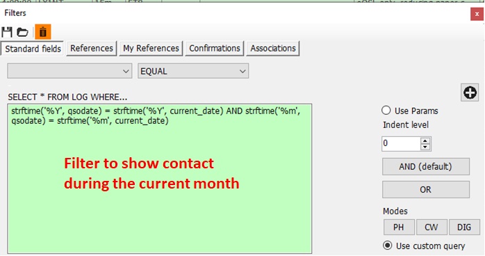

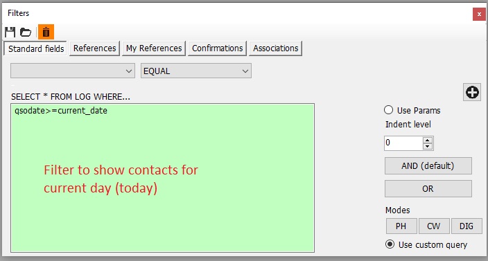

If it may be of general interest, I leave what I do to make it easier for you to know which/how many qso I did on the present day or in the present month.
Although it is possible to create a filter using the conventional fields, I preferred to create the condition but doing it with a "custom query" and recorded with the name identifying the one that concerns.
Who wants to test , I here leave the images with the query, then should write with the name you want to open in the future by clicking on the one you want.

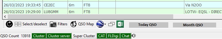

Now invading the work of Log4OM Team, what do you think of the possibility of creating one or two buttons, to associate with the queries created and recorded, being easier to access the information, or that the buttons already had the query associated by code.
And now I leave the images, two with the code and a final with the possible buttons already with the internal queries in code or that could be configured and associated with queries curated by the user.
