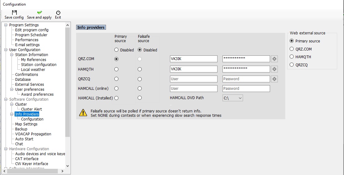

I had the slow response time issue as well. I disabled the failsafe source in Info Providers and it seems to work fine now. See photo.
LOG4OM Info.jpg (126.76 KiB) Viewed 1580 times
