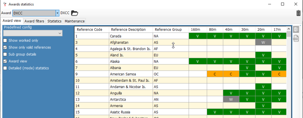

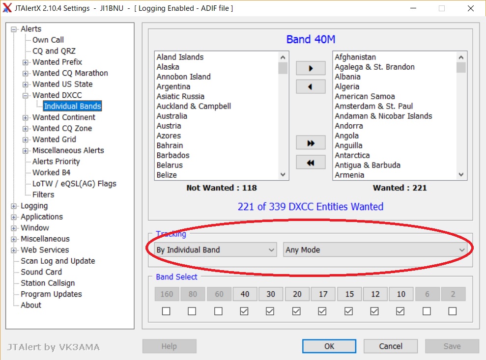

Is there a way to update JTAlert's Wanted and Not Wanted in Settings to reflect the LOG4OM Awards Status. I love the JTAlert colors that show needed countries. But to change JTAlert Alert Type Colors from Wanted to Worked you have to open up LOG4OM Awards status and JTAlert Wanted and manually compare the two lists and manually update. I would like LOG4OM to automatically update JTAward as QSO is verified in LOG4OM. I tried to find it in the manual. If I overlooked it sorry. Please point me in the right direction with page.
If it doesn't can it be added maybe in an update to LOG4OM? It may be a programmers nightmare for you.
Hope the photos help my question.
LOG4OM Award status.png (90.25 KiB) Viewed 1138 times
JTAlert Wanted.jpg (197.34 KiB) Viewed 1138 times

As far as JTAlert knowing what DXCCs you have confirmed, in JTAlert, go to Settings/Rebuild Alert Database. Once there, make sure everything is set up the way you want it. Then click "Rebuild All (enabled)". Any further discussion of this is probably better handled on the JTAlert Groups.io list:
https://hamapps.groups.io/g/Support
