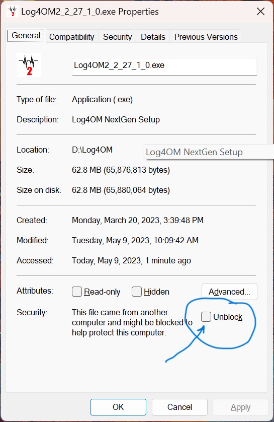

Answering my own question. I worked this one with MS help and discovered that if I viewed the properties of the install file, there is now a "box" titled "Unblock" under the security section. If you have this problem, then:
1. Right-click the file and select "Properties"
2. On the General tab, look at the bottom (see below) and be sure the "Unblock" box is checked, then apply the change.
