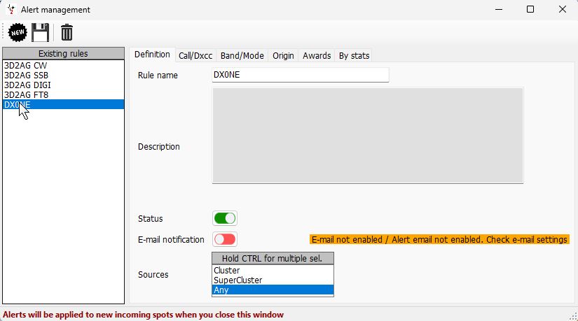

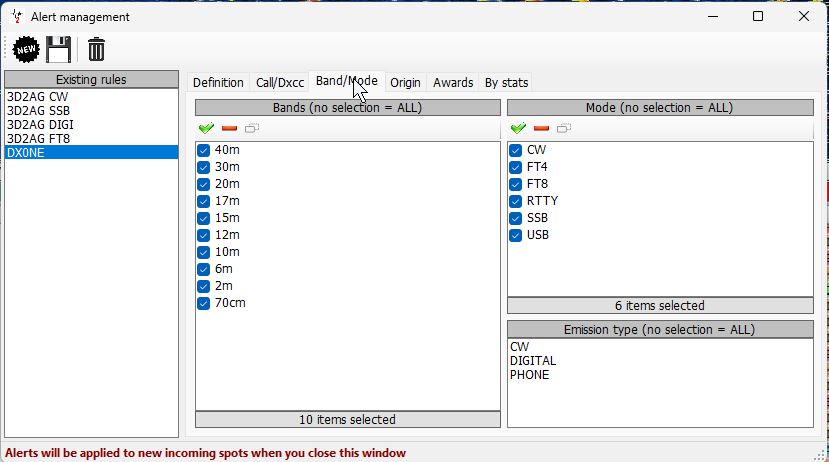

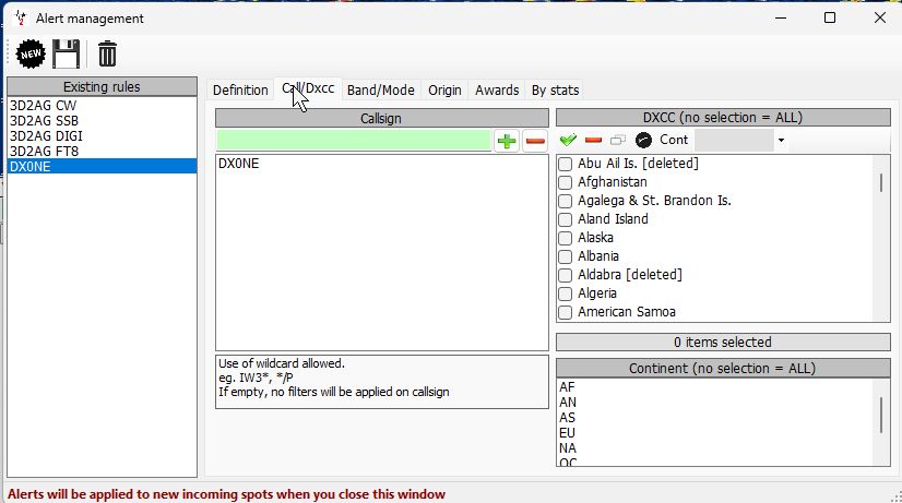

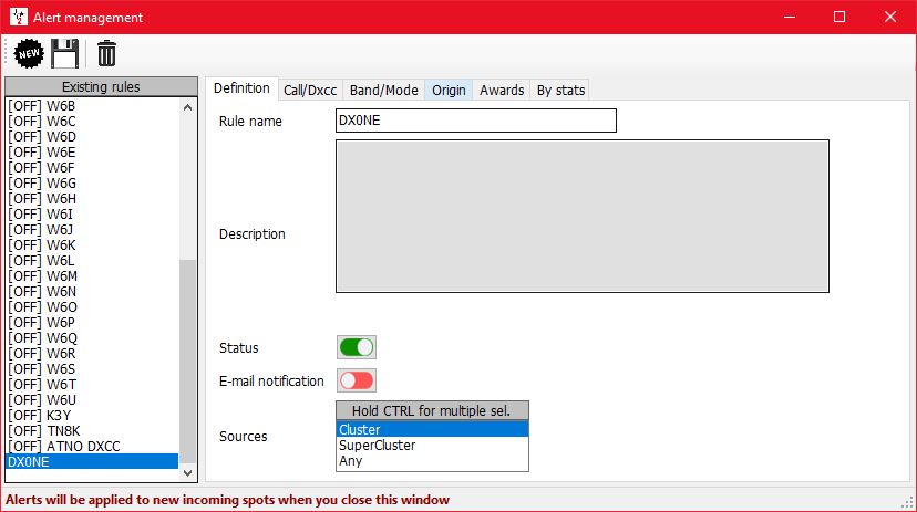

Good morning
my alert for DX0NE is not working but I don't know why, other alerts are working fine
If you had some good ideas :-)
THANKS
2023-05-06 08_52_37.jpg (51.23 KiB) Viewed 1094 times
2023-05-06 08_52_31.jpg (53.77 KiB) Viewed 1094 times
2023-05-06 08_52_25.jpg (38.96 KiB) Viewed 1094 times

Dan,

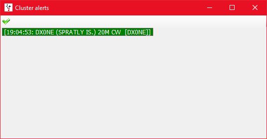

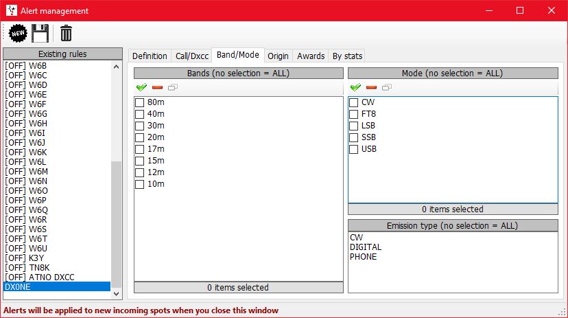

I created an alert for dx0ne and did a simulation test and it worked FB for me.
For Sources I chose: "Cluster" I did not utilize or even test "Any"
For Band/Mode I did not make any selections as if you leave as: "no selection" Log4OM assumes ALL.
I'll give another test with "Any" and see if that causes me what you are experiencing.

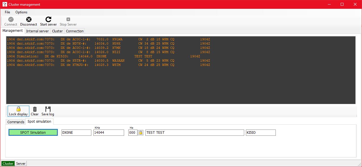

Re: Alert problem
Dan,
I just did 3 tests (Spot Simulation) with the "Any" Source chosen and did NOT get an alert on any of the tests.
Looks like you might have come across a bug where the "Any" Source is not functioning as intended and/or broke.
I'll advise Lele and Terry.

F6FLU wrote: 08 May 2023, 20:38 Hello
Thank you very much Nolan for doing all these tests
This reassures me, I'm not just talking nonsense :-)
Dan,
Lele corrected and it now tests FB on an Alpha release we're working on.

Re: Alert problem
Dan,
Check out V 2.27.1.10 that Lele has posted to the website: https://www.log4om.com/download/
