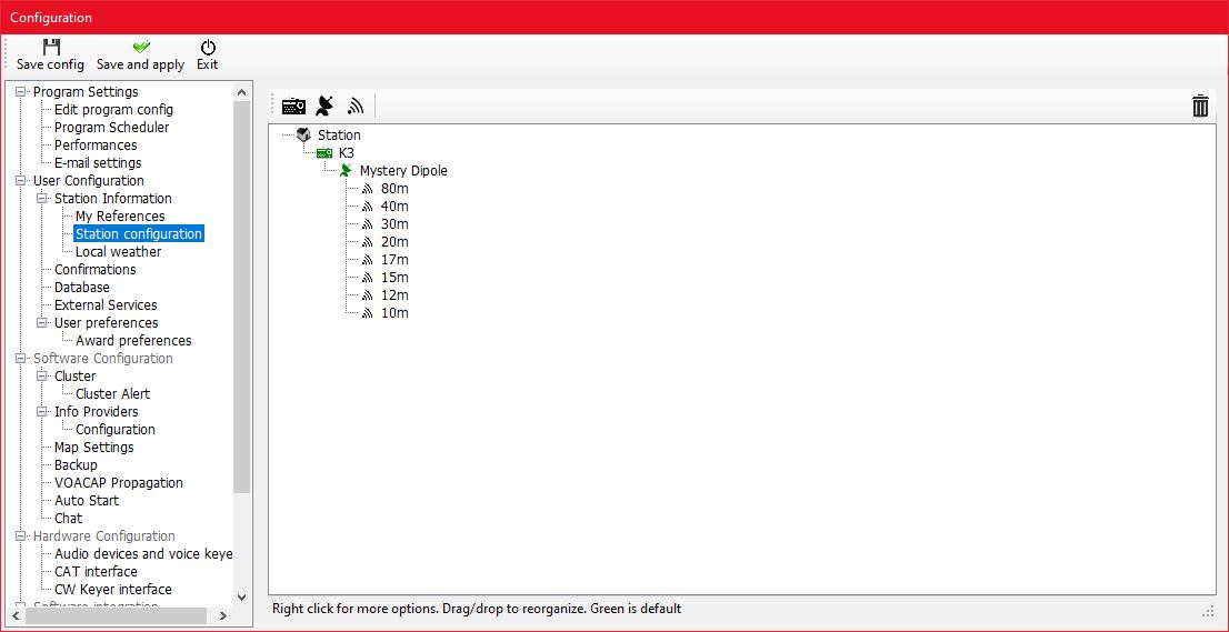

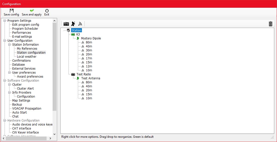

Howard,
The Station Configuration panel works just fine. You are not entering the data properly. Have you looked in the most recent User Guide on Page 188 under the Title/Label: Station Configuration ???
You can get the latest User Guide at: Help / User Guide / English (force update) ... after a span of time the U.G. will open on your computer in your preferred PDF viewer. I would then be sure to save that U.G. to your local computer for quicker access. I would also strongly recommend that you check for an updated User Guide at least once each month if not more often. Terry is always making changes to the U.G. as Lele is always updating Log4OM.
Explanation is located there and there are good prompts when at the Station Configuration panel to help you along
Once you add items / make changes you have to save them as well.
I added a Test Radio and Test Antenna and added some bands under that new Test Radio & Antenna.
So ... it is back to you not doing things properly. The program is not broken or not working as it is supposed to.
See my images below of the radio/antenna/bands I added in my Station Configuration. I've also added screen clips indicating the Test Radio and Antenna do show up in the Main UI under the My (F4) tab.
