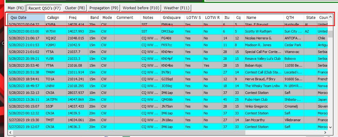

The QSL column labels may need some love. While I can distinguish the send and receive columns for Eqsl based on the column labels, LoTW labels are the same for sent and receive. As those column sizes should be rather narrows as the data values are Yes or No, I'd suggest keeping the labels rather short as well. I'd suggest Eqsl-s, Esql-r, LotW-s, LotW-r

Tom,DM1TBE wrote: 29 May 2023, 18:35 The QSL column labels may need some love. While I can distinguish the send and receive columns for Eqsl based on the column labels, LoTW labels are the same for sent and receive. As those column sizes should be rather narrows as the data values are Yes or No, I'd suggest keeping the labels rather short as well. I'd suggest Eqsl-s, Esql-r, LotW-s, LotW-r
If you 'right click' on the row of column labels and you can edit the column label titles to suit your needs.
You can also 'size' and 're-size' the width of the column labels like you can a spreadsheet. You can also move the placement of any column to suit your needs as well.
Every panel/screen with a grid can "each" have personalized column labels and positions and sizes. What you set up in Recent QSOs (F7), QSL Manager, QSO Manager, etc.. are all adjustable to suit your needs.
Everything you are asking for has been available in the program since day one.
If you look in the current User Guide the Managing Layouts topic is well documented starting on Page 30.
- recentqsos.JPG (143.2 KiB) Viewed 2702 times
