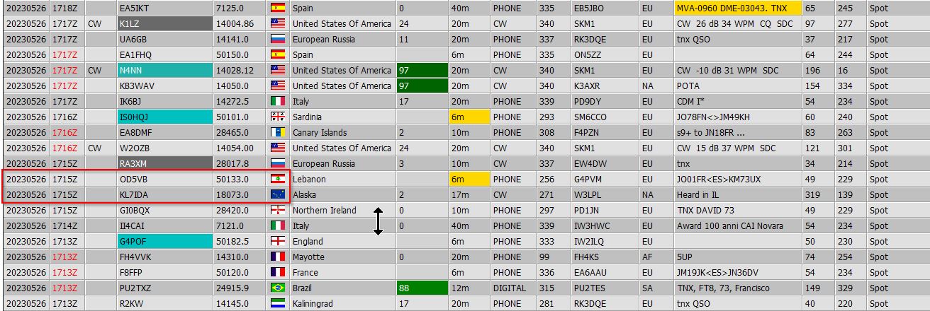

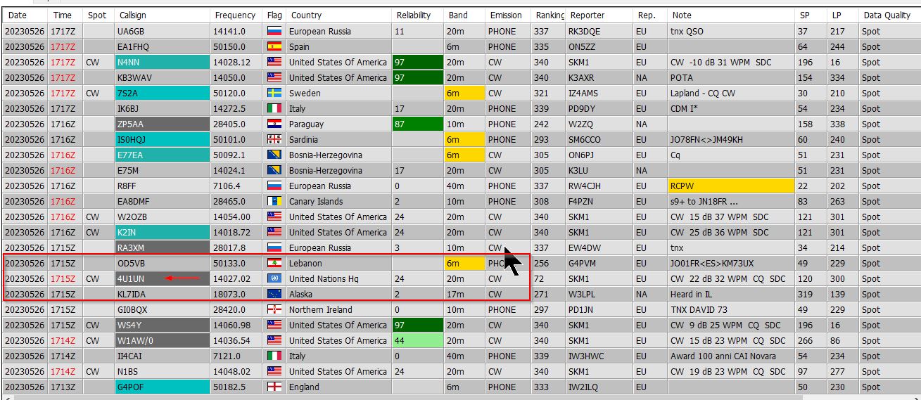

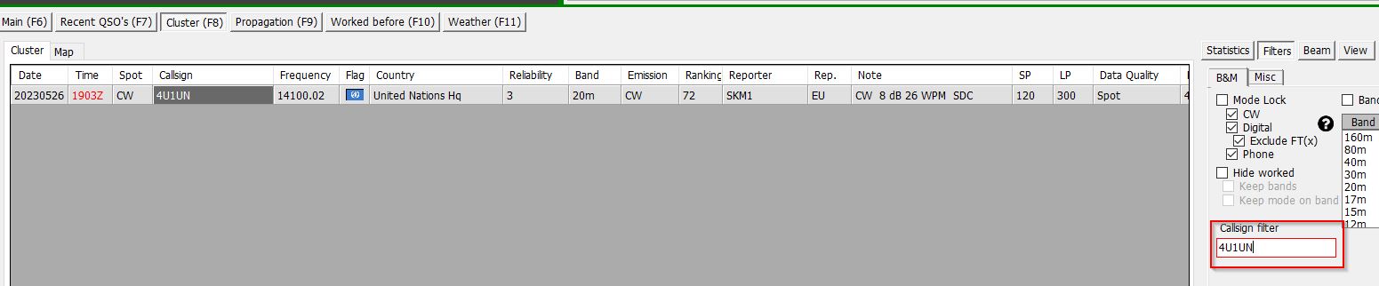

There is a new feature in latest beta called "Callsign filter" which imho is very useful.
For example, 4U1UN callsign filter will filter/display when entered in the callsign filter
But there seems to be some issues with the filter.:
-Only the very last spot arriving into LOG4OM will ever be displayed, even if many spots exist for same call by different spotters.
-Previous spots for filtered callsign are silently dropped (deleted) from cluster list
For example. We can see that 4U1UN spot was listed just after OD5VB and before KL7IDA in example below:
But then, once the filter for 4U1UN is cleared, this spot vanishes from the list. Older 4U1UN spot is removed by LOG4OM.

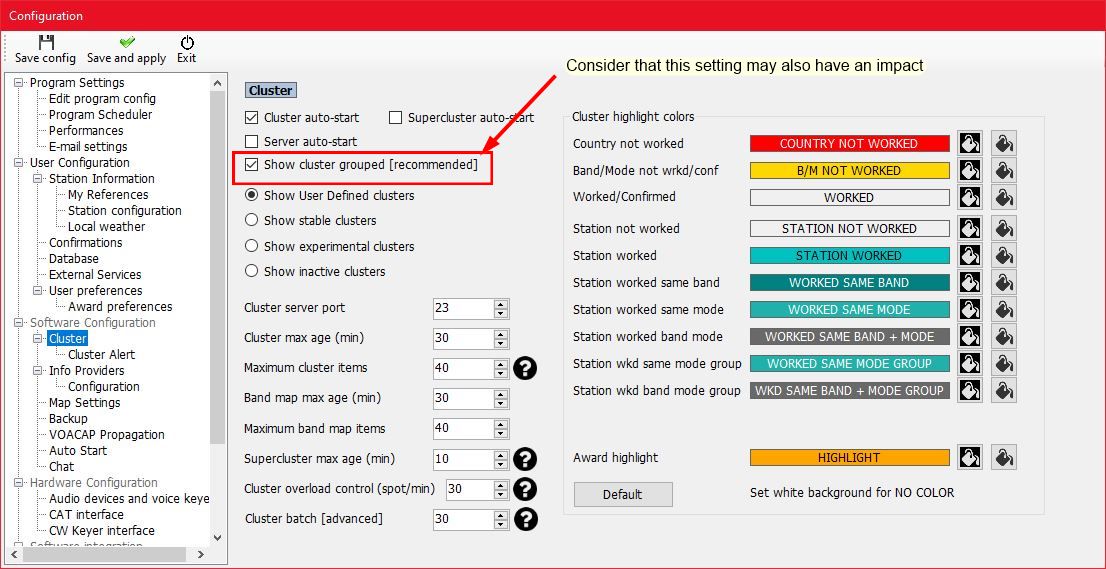

Consider also that one's Cluster settings "might" have an effect on your comments.
Grouping Clusters might have an impact, but I can't say for sure.
Just food for thought.

Hi Nolan.
I am not sure what 'Show cluster grouped [recommended]' option is meant for, but after I unchecked it, callsign filter is now working. I think this feature is great and thank you to LOG4OM author for incorporating it. Thanks for pointing this out Nolan
Re: Feedback on v2.27.1.10 beta (May 25, 2023 release)
Nikola,VE3EY wrote: 01 Jun 2023, 14:50 Hi Nolan.
That is very good to hear.
As I understand the programming behind that option is that when 'enabled' it only lets the latest spot of a given callsign appear in the cluster display. When that option is turned 'off'' your cluster display will display the same callsign multiple times that can happen with various OMs sending spots for that callsign.

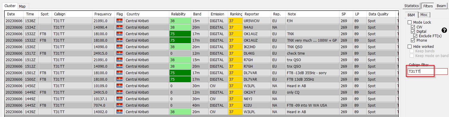

This feature ties into a feature request i submitted earlier. When a DXpedition is active simultaneously on number of bands and modes, this feature helps find out where they are currently active.
Without the callsign filter, the high volume of spots makes it impossible to track certain DX stations as the screens with spots are rolling over way too quickly
Here is an example of benefit of the Callsign filter:
