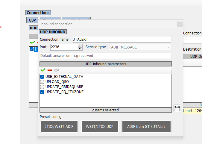

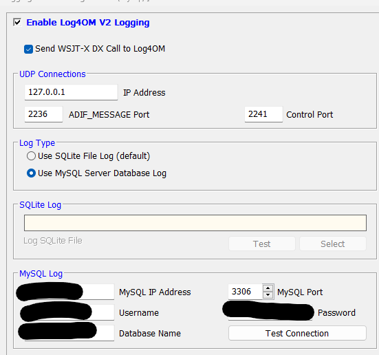

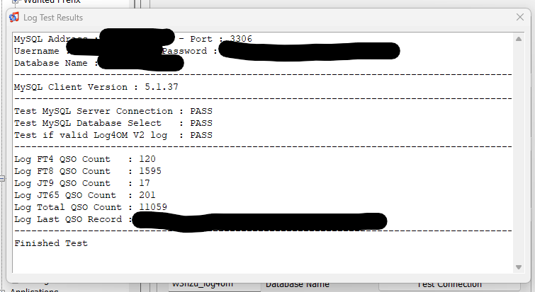

We just setup a multi-station off Log4OMV2 using MySQL. JTAlert will talk to MySQL via the test. But can not log the QSO. I have used the same settings as I have many times over when using SQLite on a single computer. I have found some old articles around this error but nothing recent. I don't know which side the issue is on here but any help will be appreciated.

I have, current thought is UDP issue into Log4om and/or something to do with MySQL. Going to setup the computer to user SQLite instead of MySQL for testing and see if it works without issue.

We are using MySQL for multiple computers and putting data into our website. The issue ended up being using another port from 2236 to make it work. The port is not in use anywhere but after trying to change the DB type and reconfiguring everything several times, ended up changing the port to fix it.
