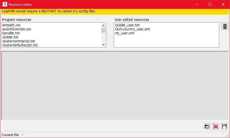

You can edit the modelist yourself for your installation.
Click: Settings / Resources Editor ...
Program resources you can modify are in the left box. Once you modify and save the particular file it will add a '_user' tag on the filename so that it will be saved going forward even with program updates.

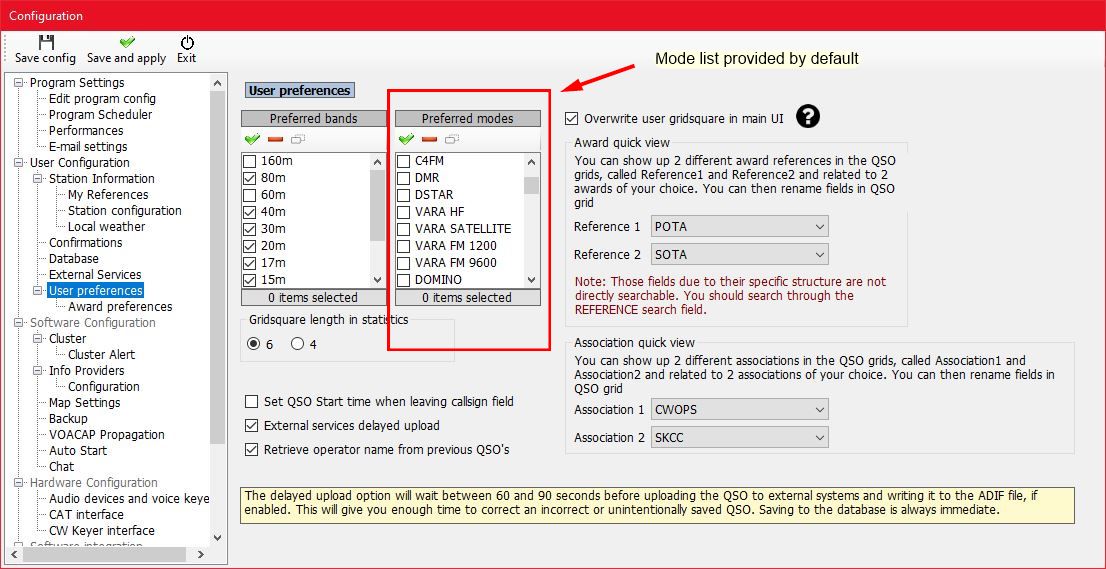

Just a thought: do you have checked VARA in "User preferences" -> "Preferred modes"?

Hi Nolan, I can see the Vara mode in the resources listing, but not in the preferred modes in user preferences? How do I enable this please?

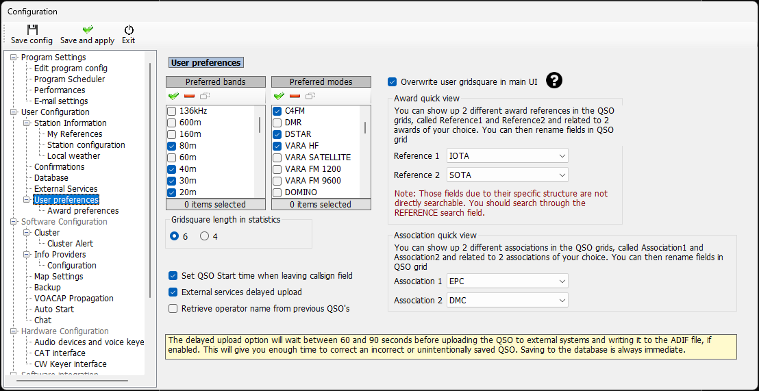

Which version of Log4OM are you using? Current release is: V2.28.0.0
Clip below shows my current list of preferred modes. Mind you I have to scroll up/down to see all the available modes.

Richard,
Do you have choices in the Preferred Modes window or is it blank?

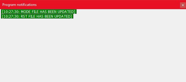

You can also go to: Settings / Update Resources / Modes
Once that routine completes you will get an alert flag next to the Main UI Note field indicating the update is complete.
