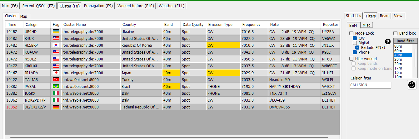

But Log4om could work even better if there could be a filter for the cluster that you can activate a certain area in the band. In the EU you are not allowed above 7,200 MHz then it would be nice if you excluded this area. You also see a lot of 7.075 while I have only checked Phone. Hopefully something can be done about this.

First be certain that you have selected the Region 1 bandplan in the 'Station info' menu of the Log4OM program congfig. You should not normally see spots outside your regional allocation so I can only guess you have this wrong!
Then edit the region 1 bandplan to your requirements re the FT8 frequencies and save the bandplan as a USER bandplan by editing the name thus bandplan_r1_user.xml
I never see spots outside region 1 and I have 6 cluster servers being agregated, see below:
If you still see spots outside the regional limits please come back to me and I will look at this again
