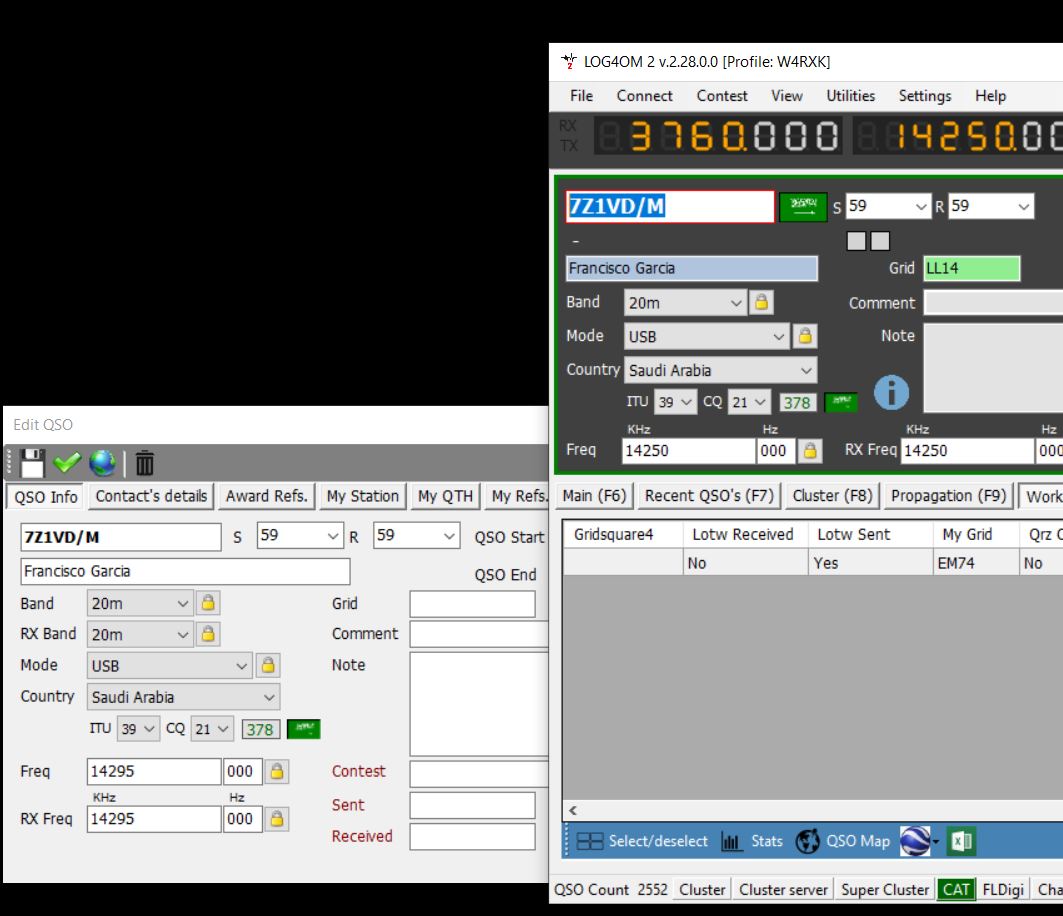

Terry/Nolan, I have another odd one here ... when I use the QSO manager to populate the grid square for my contacts missing grid information, the QSO manager returns no data for grid; however, if I paste the call sign into the main screen, it populates with a grid.
7Z1VD/M
If I choose the 'refresh data' in the QSO edit screen, it does not return grid. If I put the call sign into the new contact form, it returns the grid.

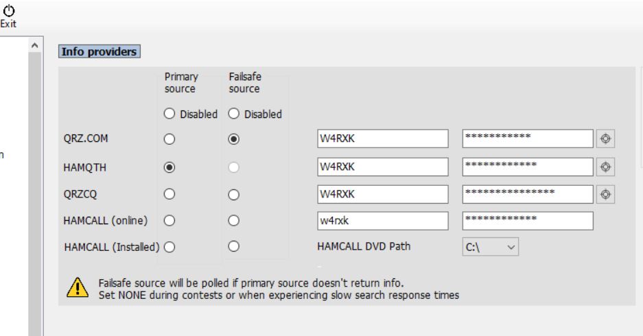

Your only a ham member with QRZ so you wont get a lookup from there and you may as well dissable it as a failsafe lookup.
Make HamQTH your primary and check it works by clicking the small round icon to the right of the password field.
As the other info providers are subscription lookups like QRZ its pointless for you to use them as failsafe lookups.
