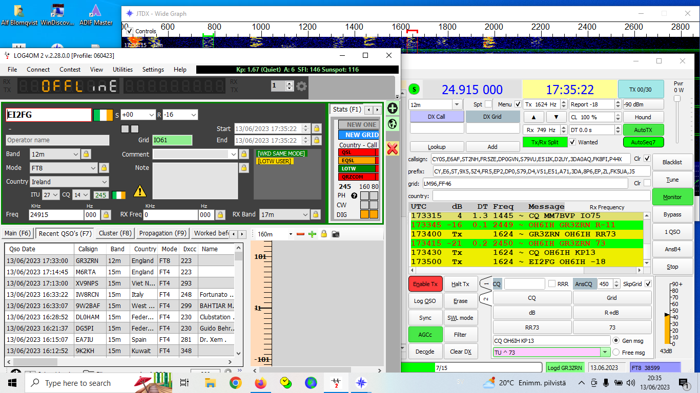

Post by oh6ih »
Operator name_html_8bc24bcca3807c4b.png (245.27 KiB) Viewed 2567 times
Hello!
A. Version 2.28.0.0
B. Info
Recent QSO's
Left column
1. Callsign is shown
2. Operator name is not shown as earlier
3. Band
etc.

Re: Operator name
Works fine here, see screenshot
Screenshot 2023-06-13 174058.png (46.4 KiB) Viewed 2577 times
Edit table layout should resolve that

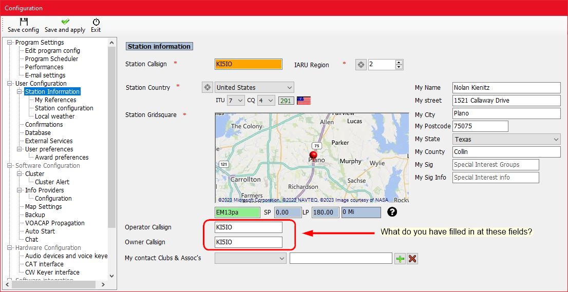

Re: Operator name
Alf,
What do you have filled in in the fields as noted in the image below?
Also ... did you adjust your table layout as Terry noted above?
OH3CEO
Posts: 4
Joined: 15 Jun 2023, 07:13
Re: Operator name
Post by OH3CEO »
Those fields I have my callsign. And yes, I have adjusted table layout.
Problem seems to be that Log4om don't read operator name from QRZ.com when issue happens. Restart makes it work again. But I can live with this.
