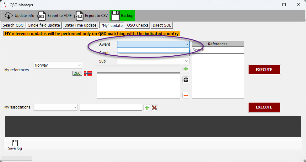

When using Lazylog the "myref" is not working anymore.
Even when trying the example in the user manual.
The first line underneath (and in picture) is my SOTA reference, and the error message. The second line is the example used in user manual, also not working.
MYREF SOTA LA/MR-128 {MyRef Award not found} *
myref IOTA EU-131 {MyRef Award not found} *
I also note that in QSO Manager, when looking at updating My References, it's missing Award. So perhaps something with my installation?
See picture

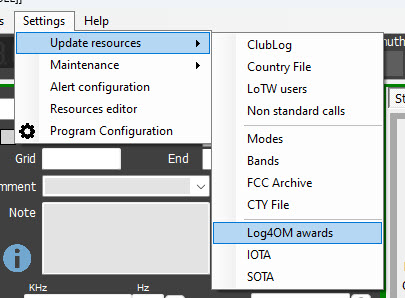

today I:
- Re-installed Log4OM (same version as I allready had installed)
- Run Settings -> Update Resources -> Log4OM Awards + IOTA + SOTA
After this I am not receiving the error message, and the awards are now available everywhere in Log4OM as normal.
I will assume it was a local issue on my computer!
