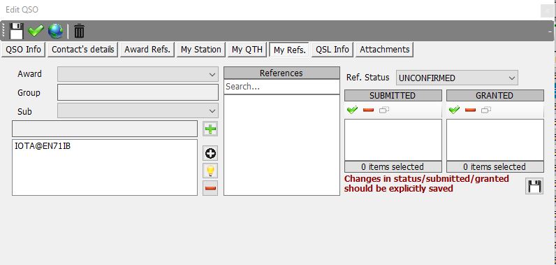

So I'm new to Log4OM, and it works awesome for most of my stuff, except this following issue when trying to upload to LOTW (took me some time to figure out that LOTW was not automatically updating when I closed the program, now I know why):
To diagnose, I manually tried to upload a contact to LOTW using the QSL manager and tried to send the upload for a single contact, but I get an error from LOTW stating that Line 9 (log file attached of the error upload), here is the error:
"The log being signed has 'IOTA' set to value 'EN71IB' which is not valid on line 9"
So when I go into the "Edit" of the contact, I see that the "My Refs." tab has line reference for an IOTA contact. Why did the software put this in there?
The contacts were auto-imported from Netlogger ADIF file monitoring for changes, but unsure why the Log4OM software created this flag and is explaining why my uploads to LOTW are failing. I verified that LOTW link is working once I removed the instance of the IOTA link and the contact will upload successful without any issue.

LOTW Uploads result in failure due to Field 9 (My Refs.)

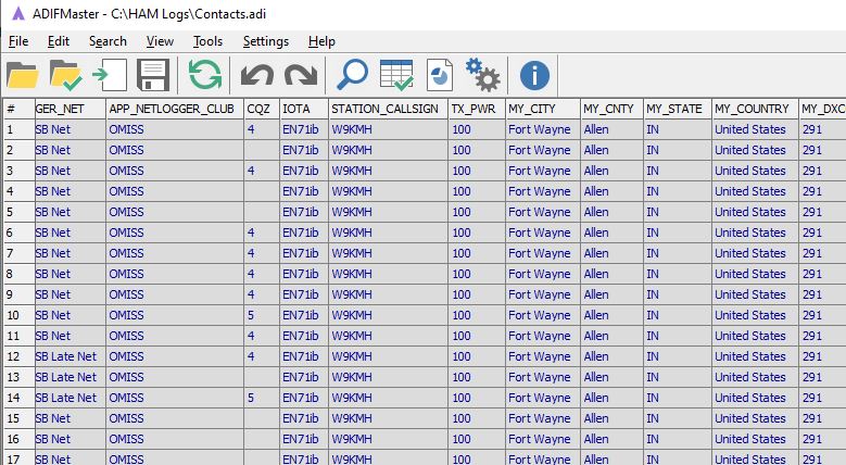

Just pulled up my ADIF editor, and I see that Netlogger is the one putting that field and data in, see here for a screenshot (and I have also attached the file). Do you have a way to filter out that, or is it some weird setting I have in Netlogger that is doing this, do you know?
G4POP, I just emailed you the ADIF file from Netlogger.
Again, I appreciate the help, I can manually edit the ADIF file and remove that reference, but if the program could filter out that field, that would be nice.

Re: LOTW Uploads result in failure due to Field 9 (My Refs.)
Hi Kevin,
Thanks for the email and ADIF file from Netlogger and yes I can see the issue and we will add this to our to do list on Mantis.
Please don’t expect to see changes in the immediate future because amending code to cope with the issues introduced by external software is not high on our priority list, far better that the other developer fixes it his end!
However we will add a routine to deal with this as soon as we have time, meanwhile bulk editing the ADIF file in notepad or ADIFmaster before import manually should not take you very long.
Kevin,
Lele and I spent some time on this today and there are so many flaws in Netloggers ADIF file that we decided not to proceed further.
Probably best for you to ask the author of Netlogger to clean up his ADIF output because apart from the issue you raised there are others like the use of the IOTA fields to store a grid reference! Like <IOTA:6>EN71ib and <My_IOTA:6>EN71ib
