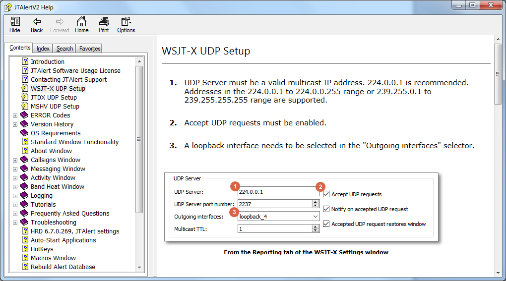

JTAlert specifies a multi-cast local address. LOG4OM only seems to work with the address set to 127.0.0.1, which is a local address that does not support multi-cast. See attachment.
My issue is that there is no dialog box in the LOG4OM UDP settings to specify the address, only the port, so changing WSJT-X's UDP address from default to a multi-cast address, as specified by JTAlert in their installation instructions from the default of 127.0.0.1, bricks LOG4OM.
You can change the address in JTAlert, you can change the address in WSJT-X, but you can't change it in LOG4OM. Or if you can't I can't seem to find where.

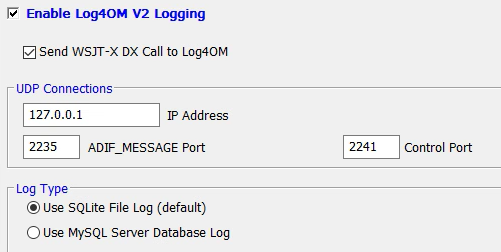

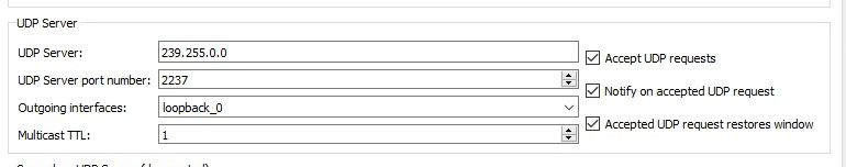

I believe the message flow you are looking for is WSJT-X -> JTAlert -> Log4OM.
Here is how that is set up on my system. Note that I use a multicast address in WSJT-X (as recommend by JTAlert) which also allows me to use GridTracker and other software.
WSJT-X Configuration:
JTAlert Log4OM Configuration:
Log4OM Configuration (2nd line):
73 Bill WT0DX

WT0DX wrote: 21 Jul 2023, 22:54 I believe the message flow you are looking for is WSJT-X -> JTAlert -> Log4OM.
73 Bill WT0DX
Thank you!

It looks like that did it! Much appreciated!
