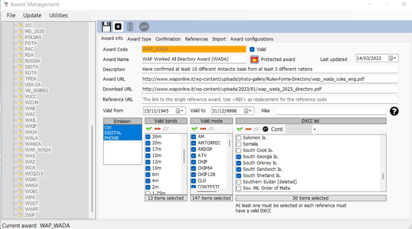

Hello guys !
I'm trying to enter a few qsl confirmations into the nice Log4OM software 2.26.0.0
This is an example CE9/R1ANF qso qsl 20 03 2005 QTH Ardley Island South Shetlands IOTA AN-010 WAB CHL-12
Problem : I can't add the ref WAB WADA : CHL-12 that I added to the database
who can help for that ?
Thank you 73
Phil F6FHO
award db updated.png (27.07 KiB) Viewed 8943 times

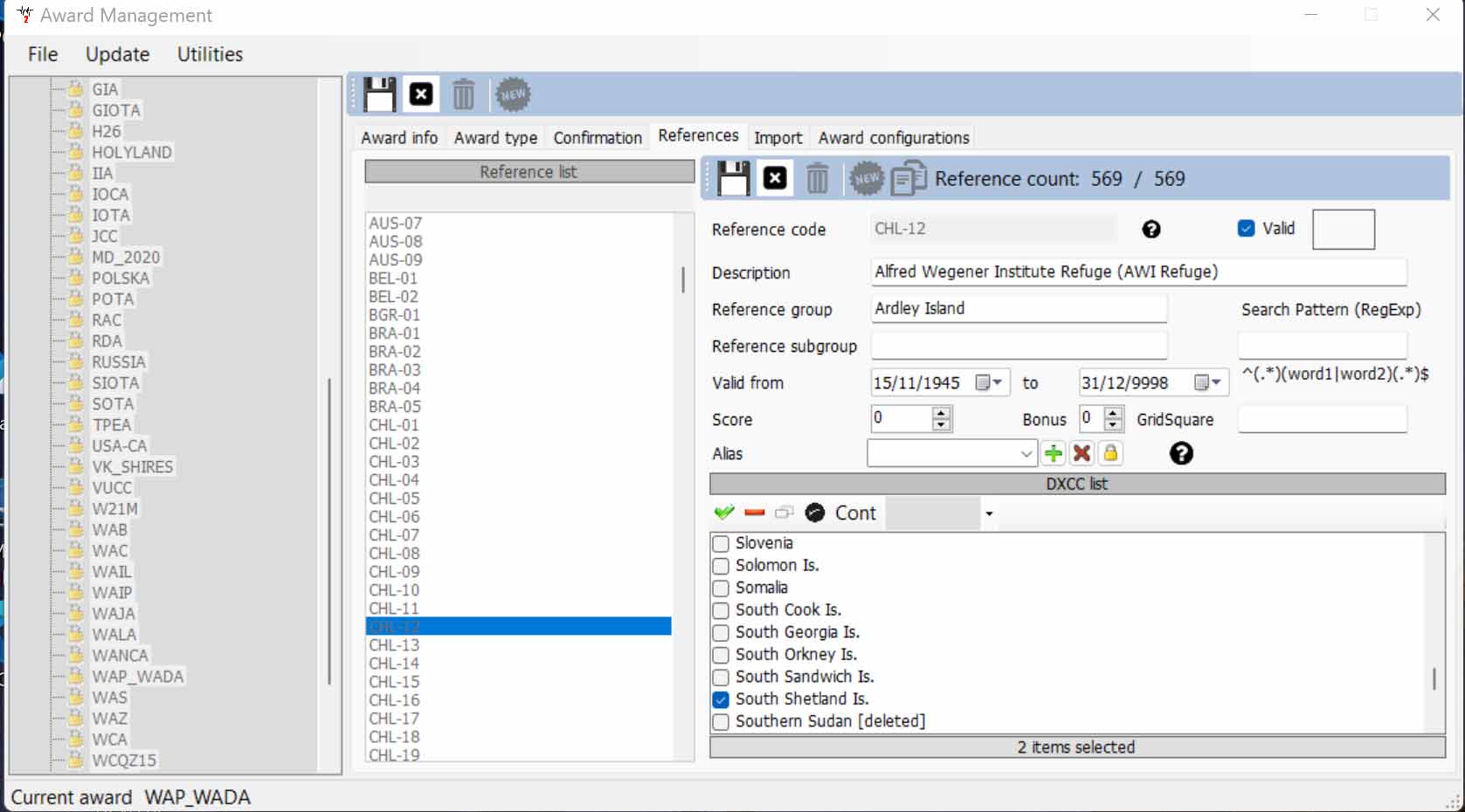

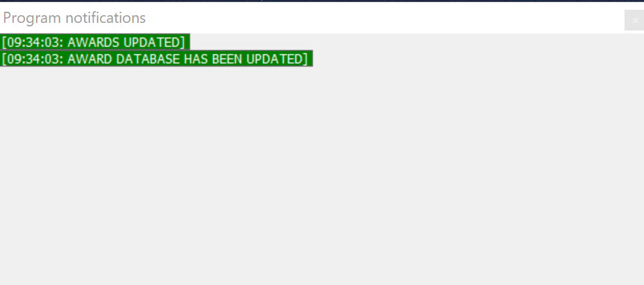

I did some further investigations, Ardley Island is not really an island but a peninsula of King George Island. I never found it on the list of the South Shetland islands on iota-world.org, so I put CHL-12 into Antarctica. I have corrected this now and uploaded the award definition. If you reload the WAP-WADA award definition, it should work.
Most probably it did not work for you, because you have checked South Shetlands but did not uncheck Antarctica.
Please let me know if this works for you now.
Claus
