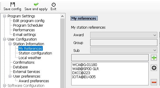

When I imort an Adif from a /P activation I do see them show up in the log.
Here's what I do
1. Go to callsign/P User configuration - My referneces and add teh WAB square and WCA reference that I was located at.
2. Save and apply configration secreen disappears.
3. Make sure my station configuratin is active as /P
4. Import my adif file

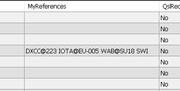

5. My references are not showing in the recent QSO's page.
Now here's a thing.
If I manually insert a QSO then the My references show, doesn't matter if I have my home configuration or /P configuration active.
So why are my references okay when I manually enter a QSO but not when I import an ADI file ??
my references 2.JPG (17.95 KiB) Viewed 618 times
my references 1.JPG (42.94 KiB) Viewed 618 times

Post by G0BON »
Doh, found the answer. I need to do a "My update" in QSO manager and execute on the imported files from the adi.
