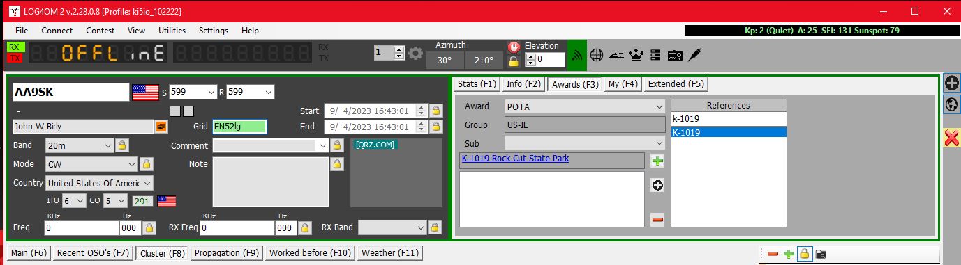

Are you calling the Awards Tab (F3) the POTA Extension? Or is that some external APP?
When I log Q's working POTA I tap the Awards Tab (F3), select POTA, then key in the POTA site. It then gets saved with the QSO and thus also ends up in the Awards Stats.
Often if the POTA or SOTA site ID is visible in the "Notes" field Log4OM will pick it up and also save it with the QSO and add it to the Awards section.

Do you have POTA, SOTA, etc. enabled as an "Active" award at: Settings / Configuration / Award preferences ?
If you do you should see POTA as an option in the dropdown on the Main UI at: Awards (F3). Assuming you have a callsign entered in the Main UI first.

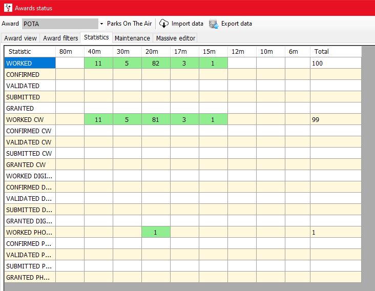

Try to rescan and see if that will bring up the QSOs brought in by the 3rd party APP.
Go to: Award Status / POTA / Maintenance ... then tap the "rescan award references"
It will take a small bit of time and 'might' be able to pick up the references on the QSOs that are imported.

Post by no4d »
Thanks for the help. I think I am on right path now.
