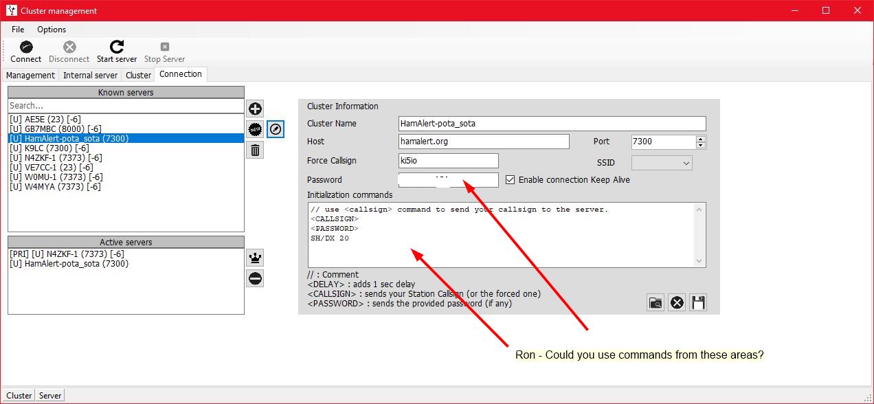

Would setting a Telnet connection with needed commands possibly work for your situation?
- telnet.JPG (90.17 KiB) Viewed 8518 times
Re: Internal cluster server response to login
The internal telnet server for Log4OM is the part of the software that I am trying to describe. This is a server that is located inside Log4OM that is used for sending spots to other software on the pc or, to other users that want to receive spots from log4OM.
