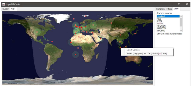

Thanks a lot for your time and your detailed answer. I am not talking about those maps, but the cluster map as shown in the usuer manual:
On my side I do not see any red squares (only my QRA) while the cluster is running and showing a bunch a spots in the table.
