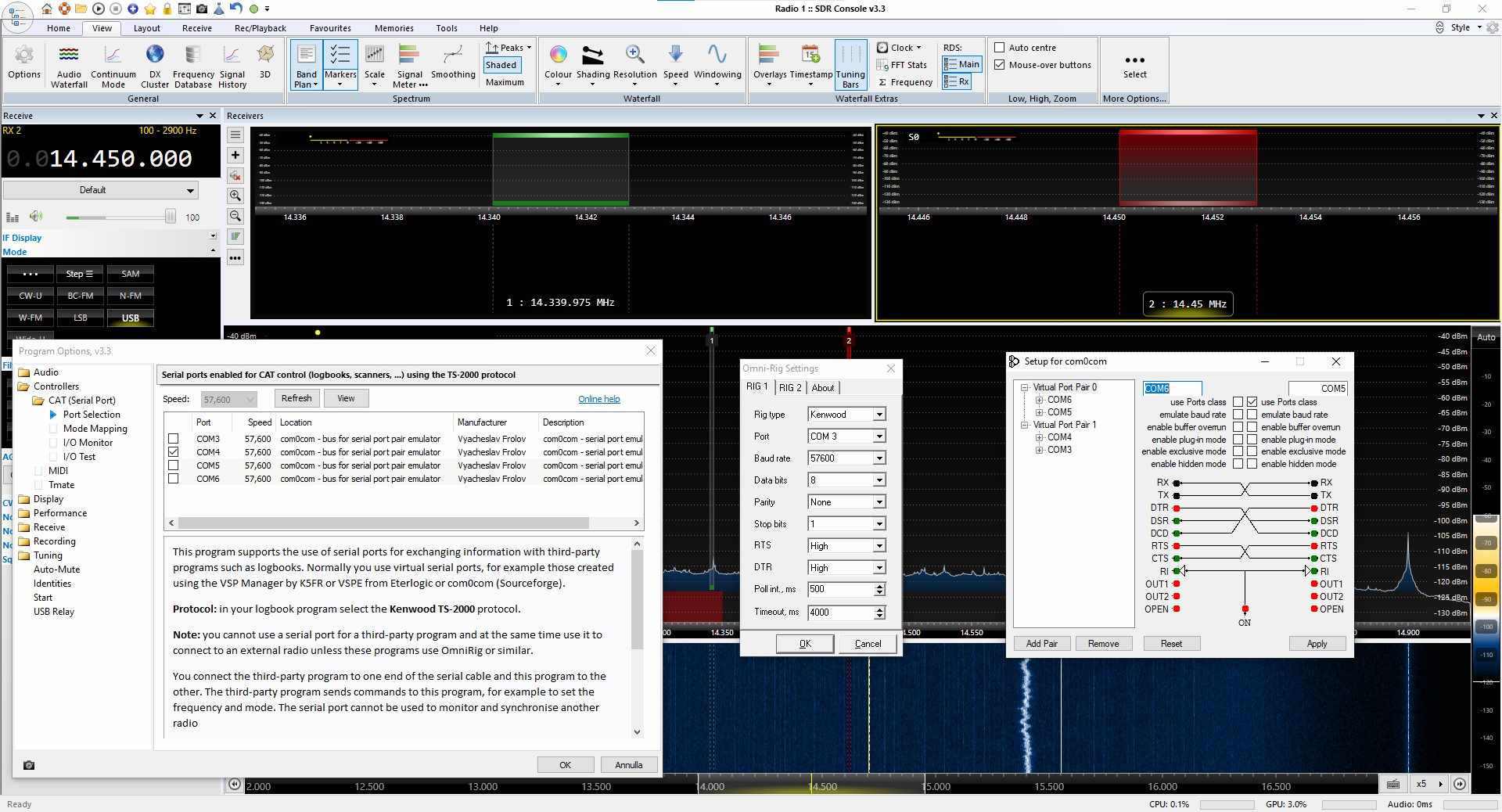

Good morning everyone!..I'm trying to use 2 instances of SDR Console connected to 2 RSP1As (and obviously to 2 different antennas) with Log4OM2 via Omnirig and related serial ports emulated via com0com
At that time....
launching the first instance (first rsp)Log4om2 correctly recognizes the console on rig 1 (serial pair 3-4)
launching the second instance (according to rsp) Log4om2 DOES NOT recognize anything, pairs com 5-6...rig 2 remains with the writing offline
I also tried to make 2 different identities but nothing changes, only the first rsp launched is recognized (com3-4)

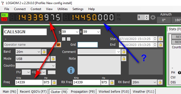

another thing I noticed is that using a single instance this is correctly recognized and functioning by log4om2 but when I try to create a second receiver this is recognized by log4om2 as vfo2 (displaying only the frequency in the appropriate box) but when selected from the console the second receiver log4om2 does not "switch" on vfo2 as happens with sdruno...

update:
I solved the main problem of the 2 instances by creating 2 identities (each of which linked to its own radio) and putting simply "keenwood" as the protocol on Omnirig instead of ts-2000... in one identity com 4 is selected and in the ' com 6 is the other... from log4om2 on rig 1 I see the first identity (com 3-4) and on rig 2 the second (com 5-6)
the problem would remain that when I activate a second receiver in the console (within the same instance) it is displayed as a second vfo in log4om2 but is not activated...which is useful for example for the right cluster
