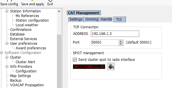

I try to use TCPIP port to control LOG40 with IC9700.
TCI is configured by : 192.168.1.10 : 50001
IC9700 IP: 192.168.1.3
UDP control port:50001
UDP serial port : 50002
UDP audio port : 50003
Network control is ON
My local gateway (box): 192.168.1.254
Subnet mask: 255.255.255.0
I can ping my IC9700, no problem, but impossible for LOG40 to connect it.
I have try with TCI directly, and via Hamlib networt, it is same. (for hamlib, port 50001 is not accepted, I have try 36000)
Peharps ports problems ?

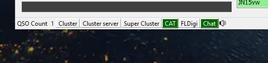

Also, I have installed Hamlib (4.5.5), configured 4532 port in my 9700, because 50001 defaut port is not accepted by Log40.
Same problem, no TCPIP communication. The CAT lamp flash only few seconds.

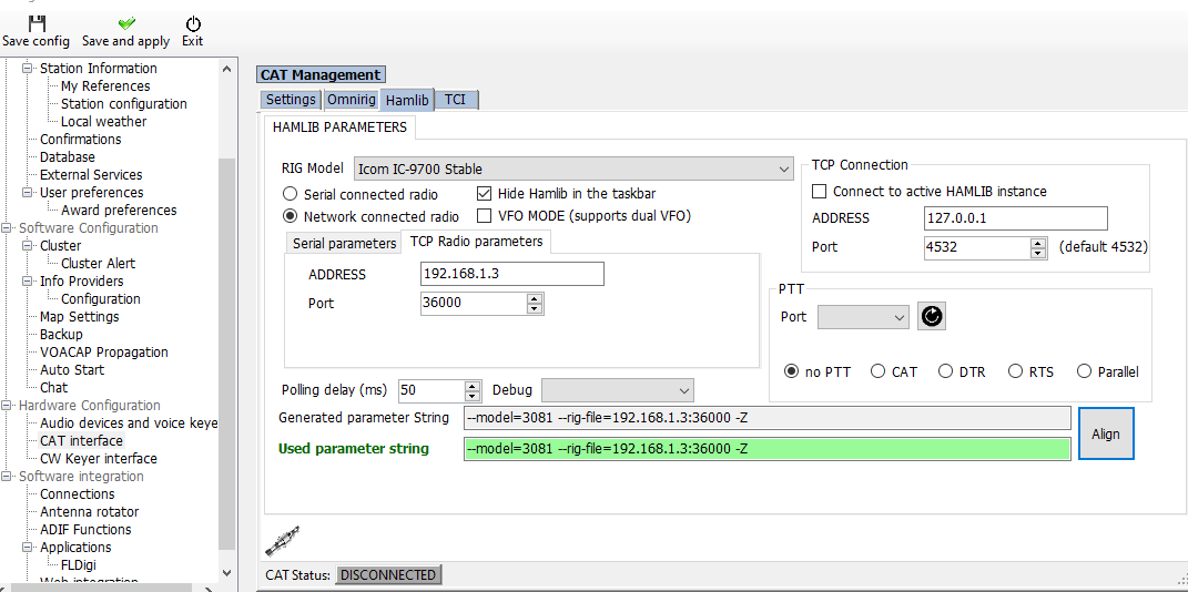

I have tryed, but TCP Radio in Hamlib do not accept my defaut port 50001, max 36000.
I have input 36000 in IC9700, same, no connexion.

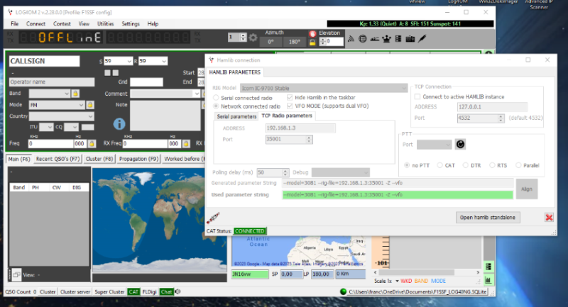

I redid a lot of tests using the same port parameters that work under WFView.

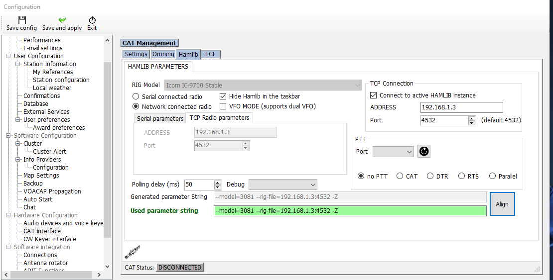

However, I see new things, if I open the menu CONNECT / Interface CAT I can force communication with Hamlib, and in this case, the CAT is now permanently connected, but still OFFLine in the display.
If you have an idea, I think the solution is not far...

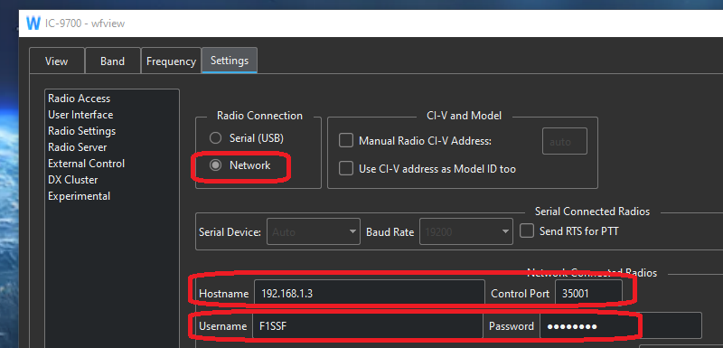

I try to find difference between LOG40 (not running over local network) and WFVIEW (running very well) and I think I have found.
In WFview, I have decalred a network user in my radio IC9700 (ID and password) and I have full connexion over local network..
If I remove ID and password on radio or on WFView, I havn't connexion. (attached WFview functionnal config)
So I wonder, there may be somewhere in Log40 an ID and password for radio access? Could the connection be simply refused?
73 Franck

I am extremely frustrated by how difficult it is to establish reliable connections using either USB or Ethernet. As a new ham (February 2023) I'm stunned how far behind the ham radio hardware and software manufacturers are. USB seems to be the goto default, but the hardware is not "Plug and Play" compatible which means we must use all kinds of tools to share the USB serial ports. And Windows also gets in the way. And even with a radio like the 7610 that has an Ethernet port, support is minimal or non-existent other than a small number of programs.
Like you, I did get WFView to work via ethernet and yes, it requires the user name and password of the user defined in the radio. But Hamlib in Log4OM does not have an option to configure a user and password which is why Im sure those connections are being rejected.
