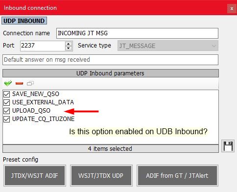

What about the QSO Upload option in the UDP Inbound items?

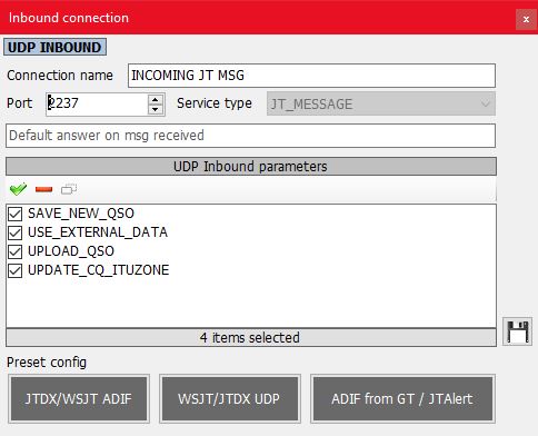

In the UDP innbound the Upload QSO was missing.
I set up the routine like the display windows you have, but no difference.

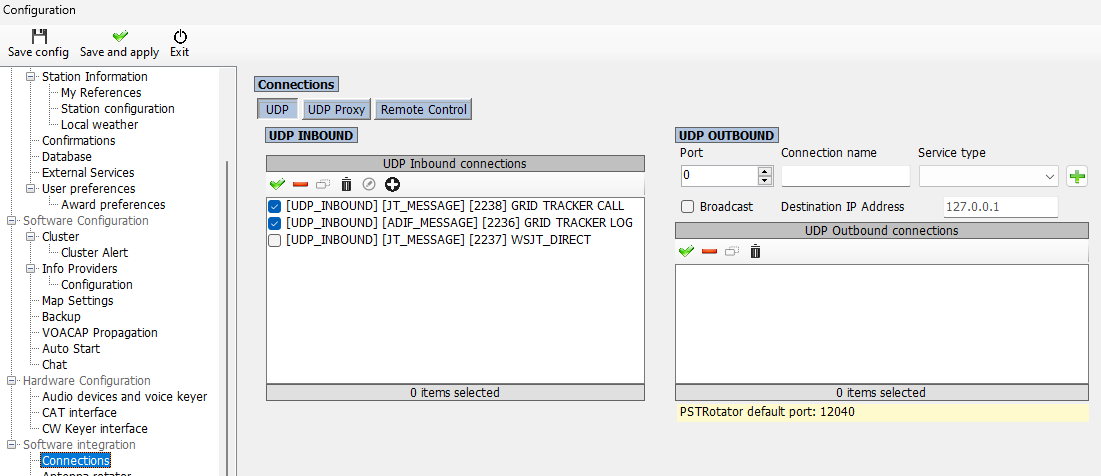

Log4OM UDP Connections Screenshot 2023-11-05 093708.png (49.11 KiB) Viewed 15948 times

What parameters have you selected for your UDP Inbound Connection for Gridtracker ??
There should be four options for you to engage or not engage as you have the need.

Thanks for the reply. Based on your response I took a closer look at my Inbound UDP connection setup in Log4OM.
I believe I may have resolved it. I had two JT Message setups similar to what you posted. One the original setup I had on port 2236. A similar setup on port 2238 which I created based on watching a video. on Youtube. The setup on port 2238 I disabled and re-enabled the setup on port 2236. This seemingly works now. Auto upload to QRZ and EQSL no work after the requisite time delay after the QSO is logged in Log4OM.
I believe the setup on port 2238 enabled Gridtracker to log to those services. I prefer to have Log4OM do the auto uploads to the various services (QRZ, ARRL, and EQSL). Hence, I disabled that UDP_INBOUND on port 2238 and all seems well for now.
I'll keep an eye on this for a day. I enjoy using Gridtracker with WSJT-X but it's very convenient to have Log4OM take care of the logging to the external services.
