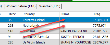

I work for many years with WSJT-x, QRZ and LOG4OM. The connections I make with WSJT-x are written away in the WSJT-x. Then I let Log4OM with Inbound listen to the ADI file on port 2238 and is then written away in the Log4OM log (and also to the QRZ that way). This always went well, but now partially.
Since the last update to v2.30.1.0, all details of the connection are retrieved and written away except the (user) Name of the opposite station. After a check, these do get placed in the WSJT-x log and QRZ log.
Could this be a bug, or do I need to adjust something in Log4OM?

Please refer to the latest user guide, release notes for previouse release and several postings on the Log4OM social media sites.
The UDP connections had to be changed because of changes in the FT8 software and the result is you need to edit the UDP connections to enable on line lookup and therefore what data is saved by Log4OM
