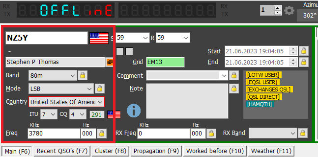

Re: Default received band and frequency?
Hello Stephen,
normally the RX Freqoency is 0 and the RX Band is empty. The only thing you need to fill in ist the TX frequency shown in the red Box
in my screenshot. Also the RST must be in. If you leave it as it is all online services accept this as a contact in the 80m band. RX QRG
is only needed for crossband satellite or things like that. Leave it blank and you´re lucky ....
Well that's even easier! I was concerned because when I looked up these qsos in LOTW it showed them as "crossband" and I know crossband contacts are not allowed for DXCC. But if I can just leave it that's even easier.
