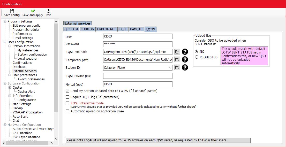

Ragnar,
What path have you put in place for your LOTW Configuration? The "temporary path" needs to be located somewhere under the "Documents" folder in the Windows O/S. Yours appears to be in a protected area under Program Files (x86).
See image below where I have my temporary path set.
Path ends in a folder I created many years ago to capture my TQSL-LOTW uploads & downloads.
