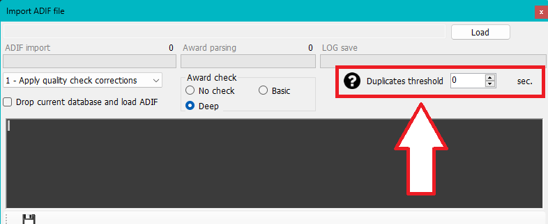

Then export an ADIF file from Log4OM and import that ADIF file into a NEW log4OM database but use the 'Duplicates threshold' in the import window set to 60 seconds

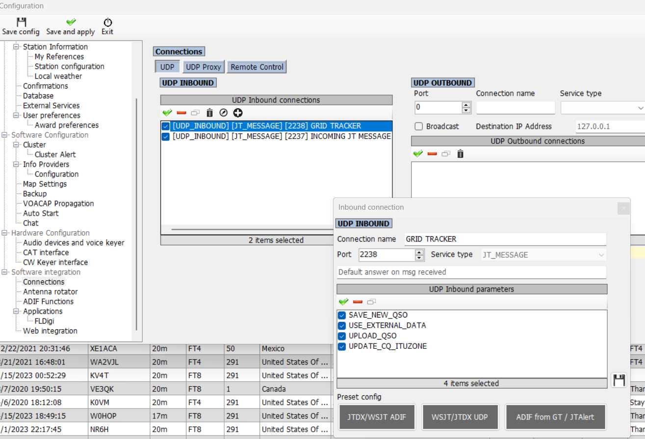

I plan to review my UDP connections because I want to integrate GridTracker in the UDP dataflow and document the setup. I also use SDRControl and it sends its log data to Log4OM. Those are received fine and never have a duplicate. I know I changed the UDP Settings in Log4OM a month or so ago because a version changed required me delete and add back the settings.
I manually deleted each duplicate log entry already so I don't believe there is a need to export and import with duplicate threshold filter. Unless you think that has other benefites?

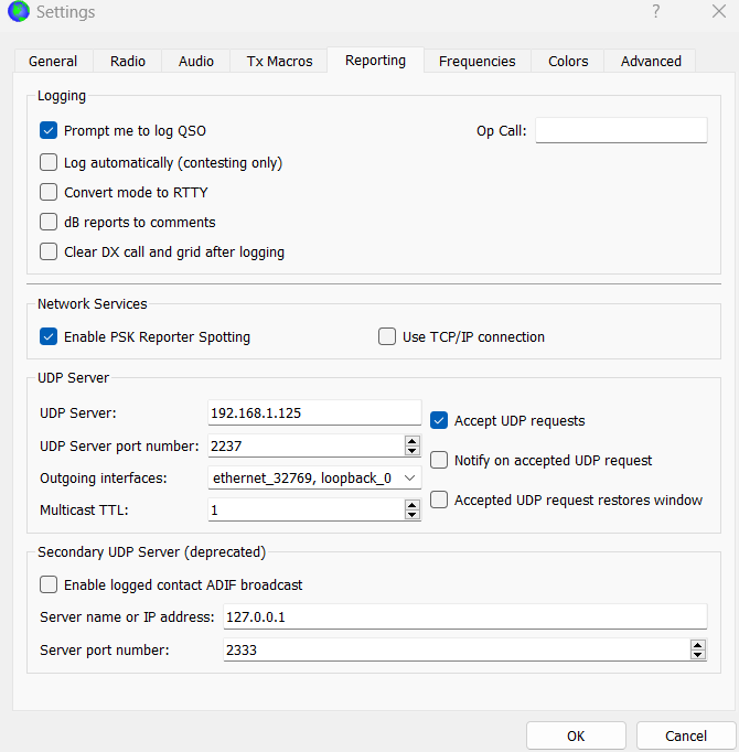

I am attaching two screen shots of my current Log4OM and one of my WSJT-X UDP settings.

Looks like you are logging the qso's from both gridtracker and wsjt, also check the 'Remote control' tab

You might be right on GridTracker. I had it loaded for a while, not really using it or convinced it was working right. This may explain the "intermittent" nature of the duplicates. I will be redoing GridTracker ASAP.
ADIF Monitor was off and remains off. However, the option on the same ADIF screen to Update Inbound Data using external sources is checked (on). Not sure if that is irrelevant because to upper checkbox to Enable ADIF monitor is off.
