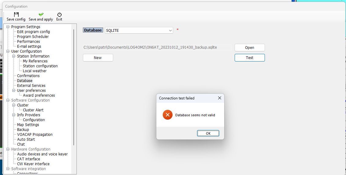

Hallo,
First of all, I'm working with version 2.30.1.0
For the umpteenth time I lost the connection with my logbook.
Fortunately, we have a backup system in LOG4OMV2.
Just my config:
My logbook is in the database under SQLITE.
C:\Users\name\Documents\LOG4OM2\ON6AT_20231012_191430_backup.sqlite (Database after the previous connection break)
Today my LOG4OMV2 v2.30.1.0 was open and everything went well.
I tried to put my contest log from last weekend in my log via File->Import ADIF.
This worked and everything was "refreshed" in the log.
After I had worked with QSL manager, suddenly nothing seemed to work anymore.
I saw my log via Recent QSO's (F7) but nothing worked.
When checking via Settings -> Program Configuration -> Database -> test
Turned out to be disconnected from the log ON6AT.sqlite
See the attachment.
So I use the backup system and use my logbook ON6AT_20240111_225415_backup.sqlite.
So now the database says C:\Users\name\Documents\LOG4OM2\ ON6AT_20240111_225415_backup.sqlite and in the test it was ok.
I left the program open 1 hour And suddenly I lost the connection again.
If I had to work with a NAS or a cloud, I would think that the connection is bad or interrupted. But on your own drive?
So, I close the PC and start over again.
I have install again the backup logboek and see what happing.
But I still sending this error story.
73 Patrick ON6AT
Database not valid.jpg (61.16 KiB) Viewed 23492 times
73 Patrick ON6AT
Member UBA-IPA
WCA: ON-01354
