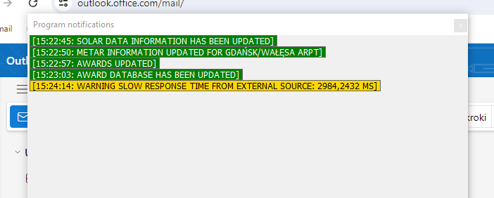

N1NQD wrote: 04 Nov 2023, 18:35 I just update to 2.29.0.0 from 2.23, and having some issues. First, when I log a QSO, the contact's details, although found in that tab, do NOT make to the logging screen. Second, although I have verified my QRZ.COM info, key and preferences, the qso does NOT download to QRZ.COM, which it normally would after a couple of minutes. Even doing a shutdown and restart (which DOES trigger LOTW to upload (YES)), QRZ.COM remains as requested. I need some help here. Thanks-Barry N1NQD
I've simmilar problem. I can upload my log to QRZ.com but I didnt see contact info.
Unfortunetly noone respond for my question.
I see troblem with time connection. but Still I dont know how to fix it.
