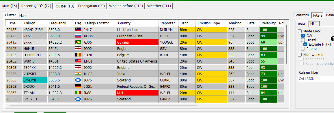

You can highlight the mode not worked in config
Posts: 11587
Re: Questing for DX for a specific mode (CW)/Spotting
The yellow highlights mean I have not worked that country using that mode and in a couple of places not worked the country on that band/mode
Those highlights are set in the program config by the user as I said in my last post
