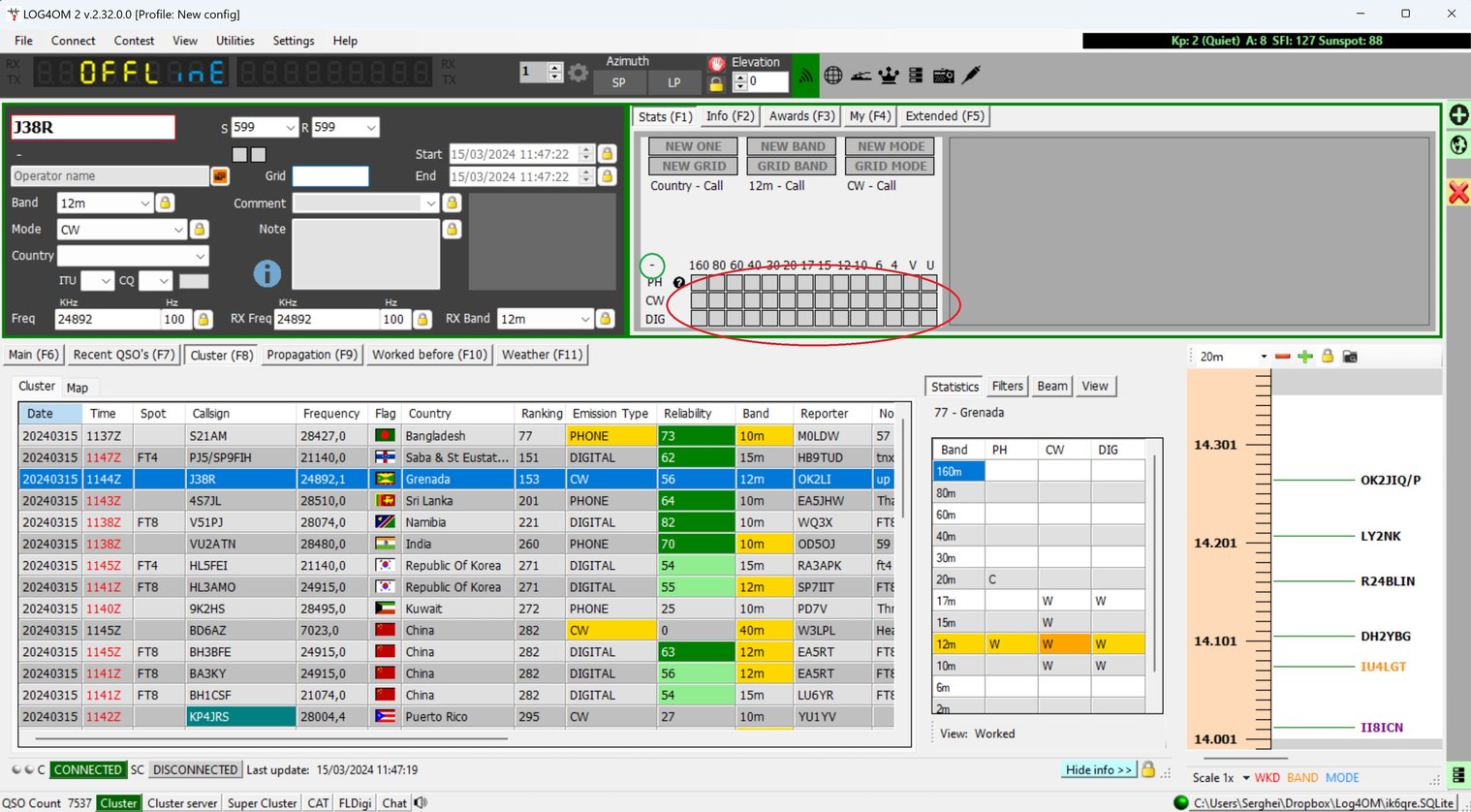

I just installed last release and I can see no more the statistics about countries as you can see in attachment pic.
Except for PJ5/SP9FIH... So strange...
Can you help me?
Many thanks and 73
de Sergio - IK6QRE
Missing stats (F1) in 2.32.0.0
- Senza titolo.jpg (244.14 KiB) Viewed 2481 times

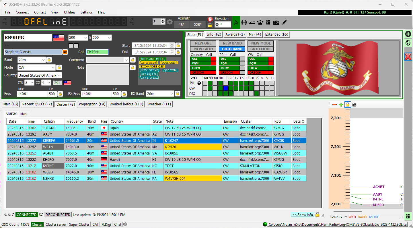

Re: Missing stats (F1) in 2.32.2.0.0
Sergio,
I have the same release of Log4OM running as you do and my stats, etc. are showing up.
Not sure what to suggest, but maybe try to re-install the new release?
- Main-UI-2.png (234.62 KiB) Viewed 2464 times
I would like to explain better what is happening.
I only verified it now.
If I capture the callsign from the cluster it will go to the upper box where we normally insert the station to work.
In this case the statistics page is not updated (blank as in the pic).
However, if I enter the callsign manually (or even by taking it from the cluster and then correct it or rewriting) the statistics work normally.
Now I went back to the previous version 2.31.0.0 and this problem does not occur.

Re: Missing stats (F1) in 2.32.0.0
I confirm the same problem that Sergio has encountered. If I write the Call by hand, the State (F1) works; Instead if you load a call with a double click (from JTDX, WSJT, cluster) the window remains gray as from Sergio photo. The red writing "Data Lookup" appears but does not update the state.
Just delete the last letter and rewrite it by hand that the state is updated correctly. I hope I was clear with my English.
73, Dom. Ik1zof
73, Dom. Ik1zof
