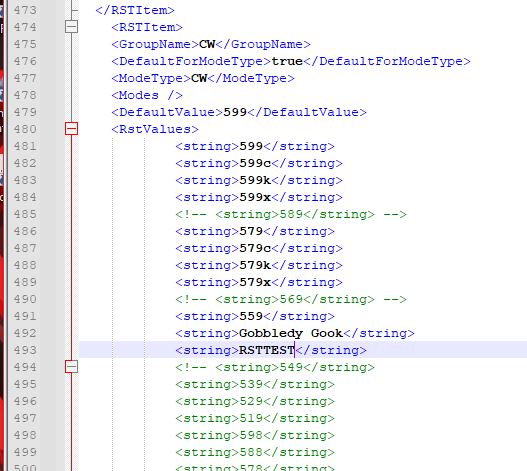

That being said, I've also modified my rst.xml file to better suit my needs/desires. Pls review Lele's post above where he mentions how each of us can use the Log4OM V2 Resource Editor to edit the rst.xml file as we desire.
The edited file is then named rst_user.xml and will take precedence over the rst.xml file. You can edit as needed and/or delete if desired and Log4OM V2 will then again use the default file.
All is very flexible this way. A very helpful approach so each OM can set things up in a customized way.
You can reach the Resource Editor at: Settings / Resource Editor The program resources you can edit are in the left panel and the edited resources are in the right panel.

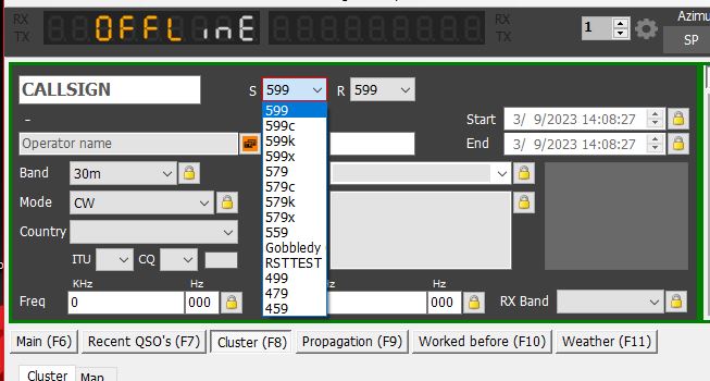

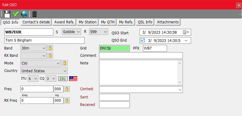

I've provided JPGs below of the current values I've added for the sake of testing (again) to demonstrate the edited RST.xml file and how it appears in the drop-down, etc..
In this case I've pretty much commented out all the RST values below 459 ... as noted for the sake of testing.
Again ... it is a personal operating choice. It would likely not be of much value (for my operating) to have RST values to choose from at 200 or below. I'm sure you could be critical of my statement of such, but that is simply "my" operating view.

As for your query about the RST values for S and R ... Currently, should you edit your rst.xml file you will find that the changes you have made will appear in both the S and R dropdowns. You can add whatever you choose in that edited file and use as you see fit. Don't overthink your operating or you might be chipping away at the overall enjoyment you do have with your amateur radio operating. It is a hobby, not a job and we all do our very best to enjoy our hobby.
