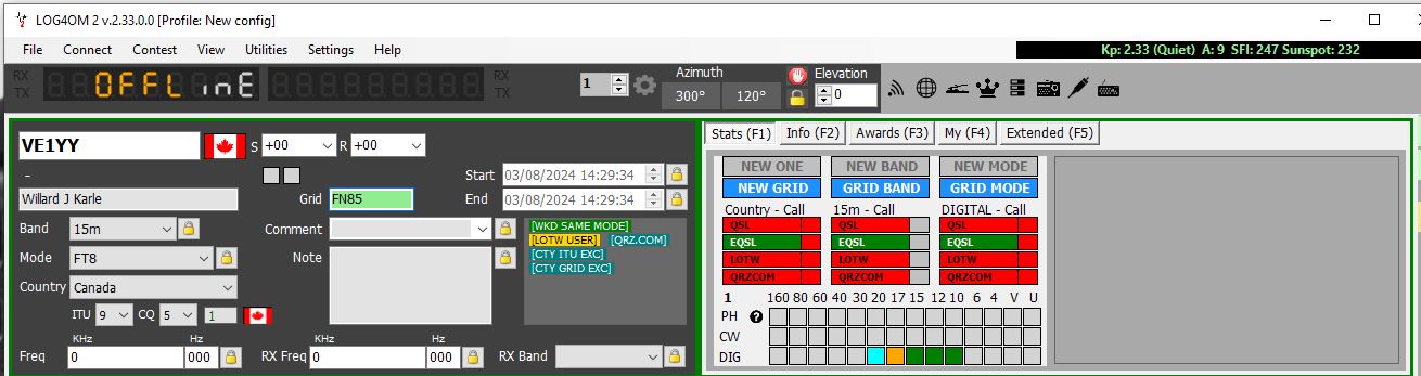

I have gone into External services in Settings/Program configuration set QRZ.com , Clublog ,HRDLOG.net , Ham QTH , LOTW now what i need to know on closure of Log4OM will it update all of my contacts or just the last few ? whilst i am here can anyone tell me why i have many stations confirmed on lotw but they are not Confirmfed in Log4OM here is just one
