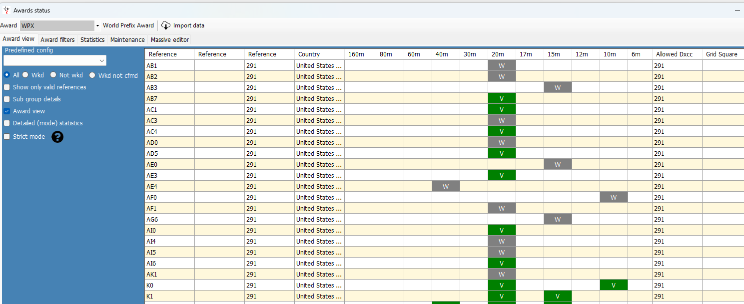

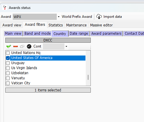

Hello All,
I am trying to work on my WPX Award and I am having trouble getting it to display prefixes that I have never contacted. The attached picture shows the display with a country filter of Unites States.
It shows prefixes for stations I have worked but not ones that I haven't. For example AB4 is a valid prefix but not shown with ALL is ticked. I have tried tick all the various buttons and refreshing but cannot get 'not worked' prefixes to show :|

Re: Need some help with WPX Award View
Would apear the 'Not worked' button is not functioning
OK! now Lele and I have had chance to talk I understand whats happening.
This award relies on the data saved with the QSO - The prefix in this case
We have never been able to find a complete and reliable list of ALL prefixes so we cannot define those not worked - Only those worked as included and read from the log QSO data
Sorry but until someone finds a GOOD list of prefixes the not worked will be in-operative
