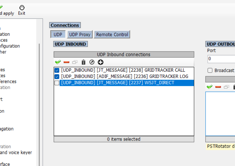

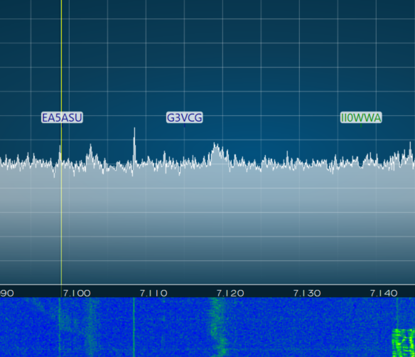

When I select a spot in the bandmap of SmartSDR, Log4OM correctly updates its frequency. However, I'd like the callsign of that spot to automatically appear in the CALLSIGN entry box of Log4OM and trigger a lookup.
I had this feature working previously, but it seems to have stopped functioning and I can't figure out how to restore it.
Log4OM is configured to perform cluster lookups and operates as my internal server on port 23. The spots are displayed in the bandmap of SmartSDR via either Slice Master 6000 or FRStack3, and both are functioning as expected.
Does anyone have any suggestions on how to fix this issue?

Re: Syncing Callsign Entry between SmartSDR and Log4OM
Thanks, Terry, for your response.
I reverted to using OmniRig instead of Slice Master to see if it would resolve the issue, but unfortunately, it didn't. If anyone has this feature working, please let me know. It's incredibly useful to have the callsign automatically looked up in Log4OM when clicking a spot in SmartSDR, just like when I click the callsign in the Log4OM band map window.
Thanks!
