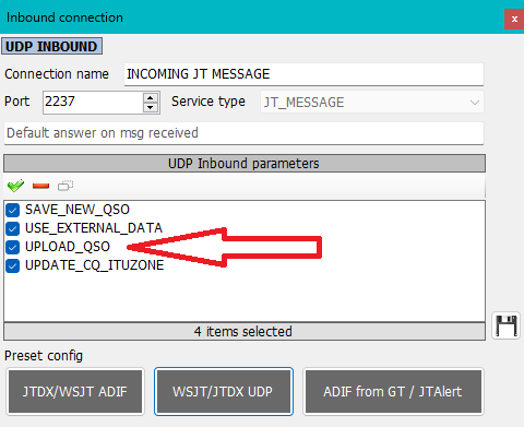

I've just set up v2.3.3 on a new PC along with all the rest of the software.
I had a few hours on WSJT-X improved, sending the logged QSOs to Log4OM in the same way I did on old PC via UDP.
The QSOs arrive in Log4OM no problem at all.
But at end of session I noticed the ONLY QSO that had been uploaded was one SSB QSO where I manually entered the details and clicked the + button in Log4OM.
Both worked fine on old PC.
Is there something I have missed?
All external services are set to automatically upload (as proven by the SSB one)
It's almost as if Log4OM is treating the WSJT QSOs like ADIF imports, which I also do and know they do not auto upload.

Thanks Terry. That was painless. Working now.
Those presets look new to me as older version on last PC, very useful indeed!!
Posts: 11591
Re: WSJT QSOs not auto uploaded to QRZ etc?
been there since March 2023
