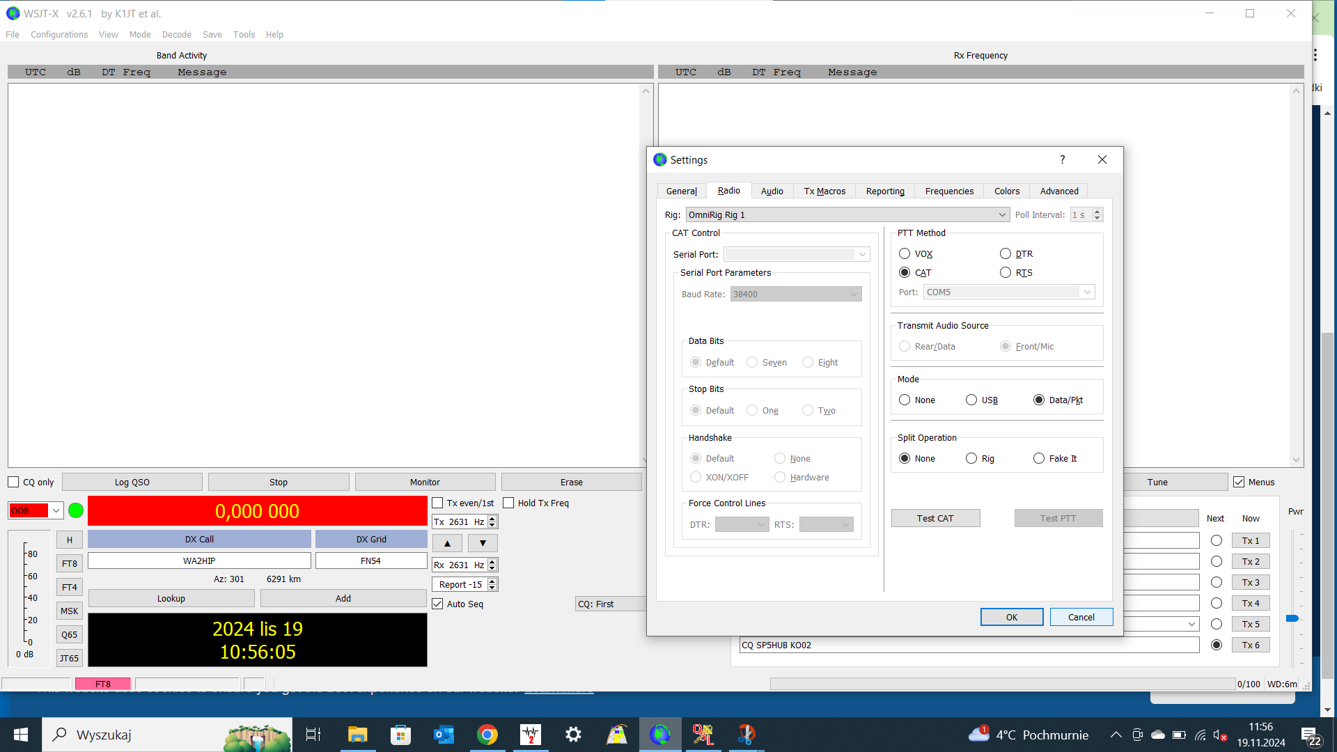

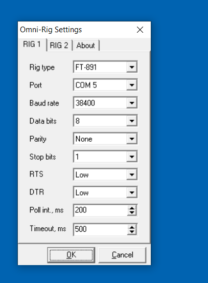

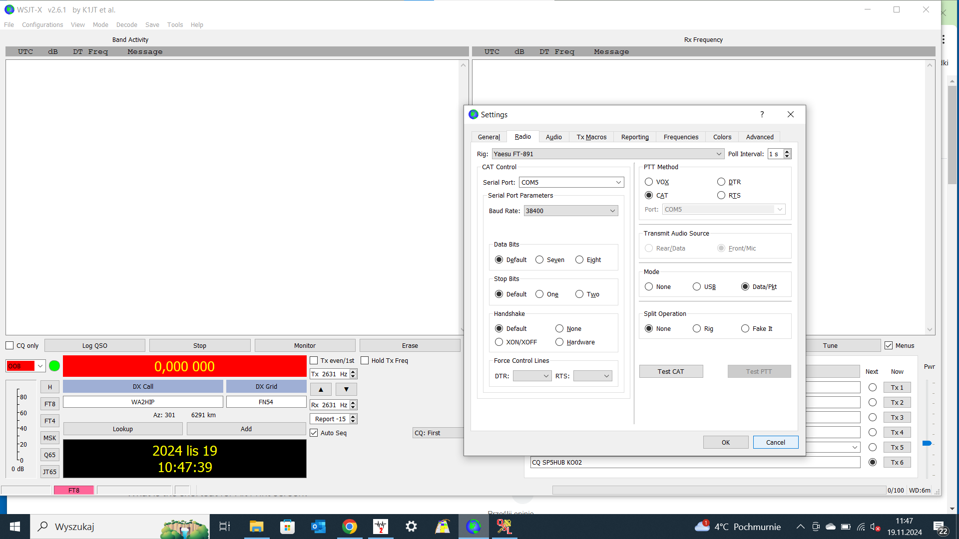

so there is a device that goes to computer via usb and there are two cables that go from the device to Yaesu and two cables that go from the device to the external sound card that is also pluged with usb to the computer.
On that printscreen I show You the option that is working that is why there is yaesu 891 in Radio.
and the second screen that is not working with omnirig as radio -> in this case I can hear the sound but neither grid tracker nor wsjtx decode it.
Log4om uses omnirig.
Thank You for Your help, I hope my case will help You develop your application

You must select omnirig rig 1 in wsjt, if wsjt, omnirig and log4om are all set to "run as an administrator" they will all function correctly together.
Can you post a screenshot of the wsjt config audio tab please
