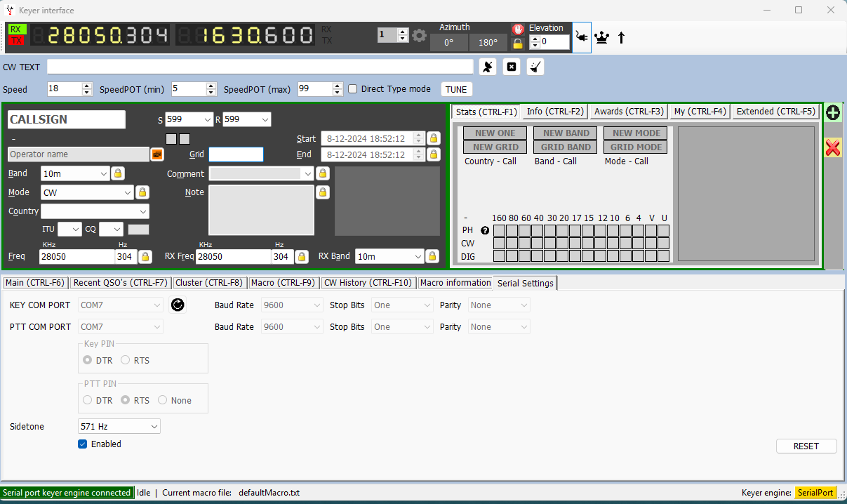

From another source, I heard that I have to choose a 2nd port to work with CW Keyer. When I look in my PC I only see COM1 and COM3 so that does not work and it does not accept COM3 because it is already in use for Log4OM itself. For this I bought a 2nd USB cable CT-17 CI-V / CAT Cable and plugged it into the back of the 7300 (CI-V Remote Control Jack). Now I have an extra port (COM7 CH343 Serial)
Now I don't know whether in the settings | CW Keyer Interface, which option I should take. (Nothing / Winkeyer / TCIProtocol or Serial. I have tried all options but I can't get my 7300 to transmit
What I have noticed is that when I put the audio from my PC on speakers, I do hear the CW that I type in via CW Keyer or use the function keys
As far as I can tell now, the CW Keyer program does provide the correct information, but my 7300 does nothing with it

As I stated when I answered your question on social media I do not have an Icom 7300 to test with!
The least expensive and most certain way to get it working is to use com port keying, using a cable from a PC USB port to the key socket on the 7300
I reccomend the Technofix cable here https://shop.technofix.uk/cables/cw-mor ... o-isolator - Beware of ebay imitations
Or you could make one yourself following these instructions https://www.n1rwy.org/?p=384
Or purchase the excellent Winkeyer USB
My Icom 7100 does not support keing via the CAT cable so I use the Technofix cable above and its fine with Log4OM.
Both my SunSDR and Hermes Lite 2 use TCI for keying and they work fine with Log4OM
My Kenwood TS480 is connected with a Winkeyer USB device and that also works fine with Log4OM
