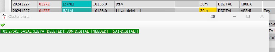

I first noticed this when I received an alert for 5A1AL . . .
Also when you attempt to record a QSO . . . the country name is not populated and the country code is RED

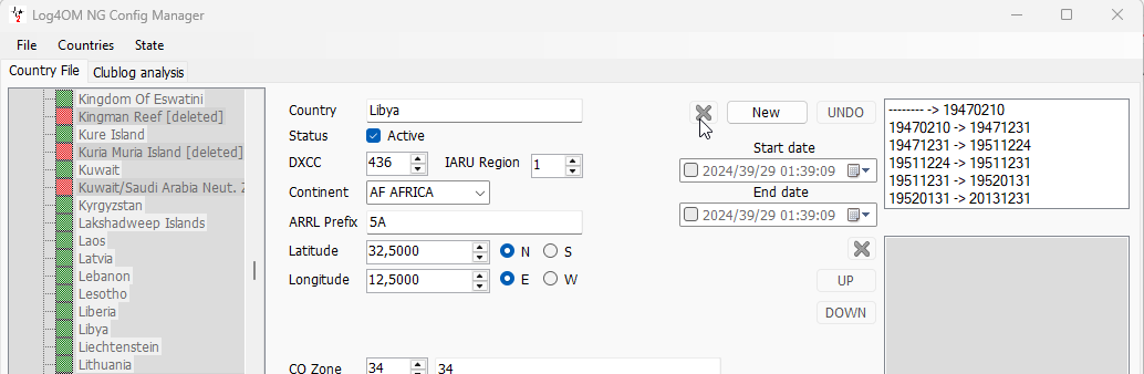

Our actual data source is Clublog. From Clublog we read the XML data provided in order to be able to identify the prefixes for each country.
As you know, prefixes vary during time, can be modified and implemented further.
For libya, the last prefix range is starting on 31/01/1952 and is reported ending on 31/12/2013,
while other countries (like italy, as example) have "end date null" in the last period.
That's the reason why Log4Om is reporting Libya as "expired country".
