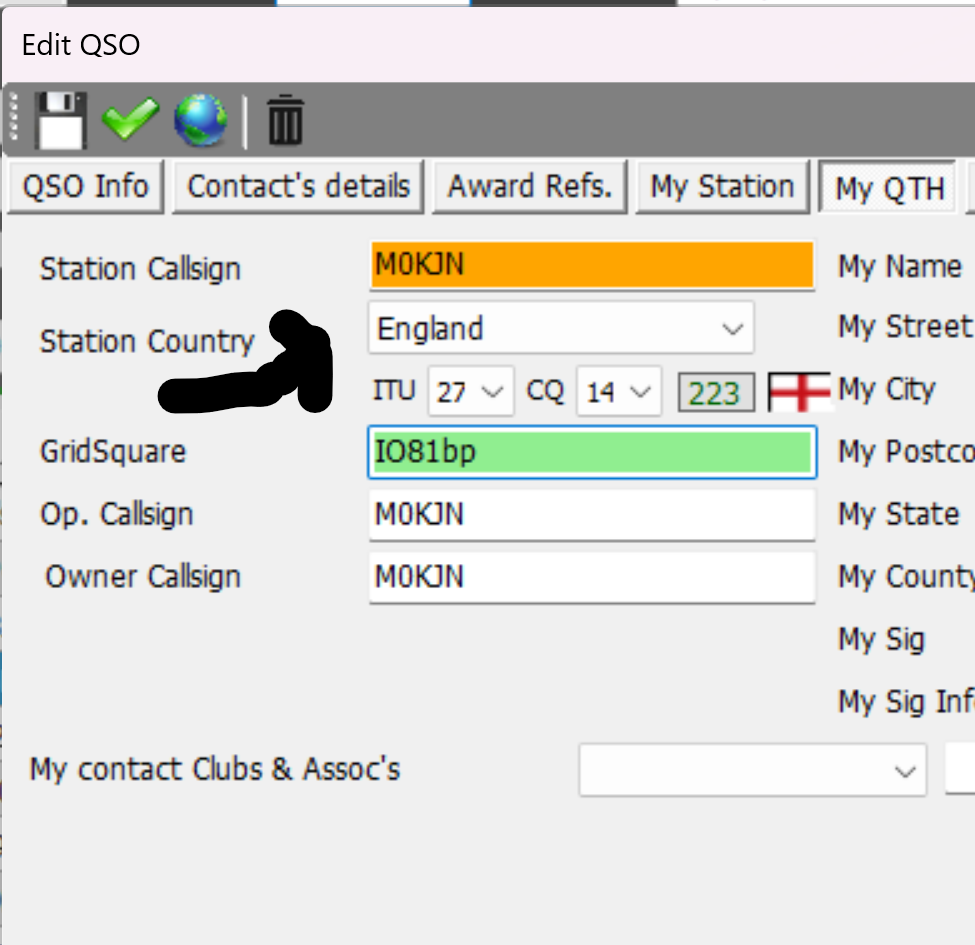

I understand that now there may be problems with callsign lookups for M0 stations in wales, but what I am seeing is a failure to upload to LOTW because of this. Im trying to work out where the problem lies.
If i work a station and manually enter into my log book on Log4OM, I see things for my callsign correctly, as :
I often use WSJT-X for FT4/8, and this is where the problem lies.
QSO's that are imported have MY information incorrect, which causes a problem when uploading to LOTW.
An example :
I wish I hadn't changed my callsign now....
What i'm trying to work out first, is where its getting that data from, and is there a way I can manually set a call sign in said database to always return, in this example Wales for M0KJN.
