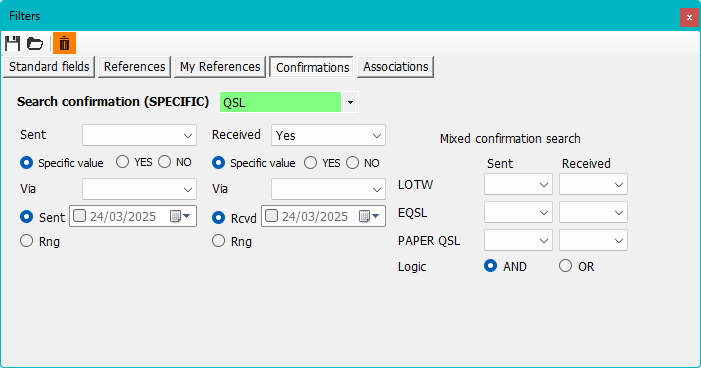

Hi all
It looks to me like this filter is for received opaper cards, not necessarily those that should be submitted for DXCC credit.
Am I wrong ?
Thanks + 73
Paul F6EXV
Posts: 11582
Re: List of CARDS for DXCC submission
Seems your only evaluating the tab displayed have you tried a combination like
In QSL Manager
Filter menu
References Tab - Award = DXCC
and
Confirmations tab - QSL received = Yes
Alternatively export to a spreadsheet and manipulate in that
