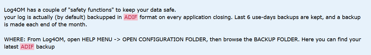

I do not see where the ADIF backup file is being saved. I found this in the documentation:
Screenshot 2025-07-01 143446.png (144.41 KiB) Viewed 91 times

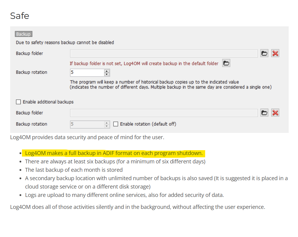

and the documentation shows this to be the saved location:
Screenshot 2025-07-01 144001.png (35.24 KiB) Viewed 91 times
In this folder I only see the config.jason files AND the backup.sqlite files. Where are or how do I auto-save the ADIF like the documentation says?

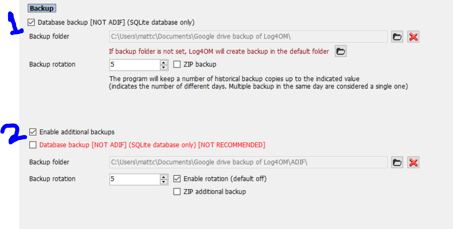

Ok i got it working. So if you check item #1 then you will not get ADIF backups unless you check item #2. (I previously only had item #1 checked) After checking #2 and selecting a directory I now get all the backups. (database, config.jason and ADIF)
Maybe the default (not checking any boxes?) will give you all three backup items?
@KI5IO the screenshot you are referring to is a screenshot from the Log4OM website. That wasn't my config.
